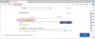

Edge:
  • Type edge://flags/ on the Edge URL field.
  • Search for TLS 1.3 hybridized Kyber support.
  • Select Disabled.
  • Select Restart.

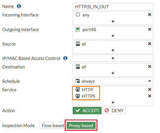

Option 2: Devices with 4GB or more: Change the firewall policy inspection mode from flow-based to proxy-based:

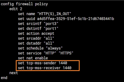

Option 3: Change the tcp-mss for sender and receiver to a value less than or equal to 1450 for firewall policies that match HTTP and HTTPS traffic. Depending on each environment and MTU path, the TCP MSS value might need to be adjusted.
Calculate the correct TCP MSS by following the steps outlined in Technical Tip: Setting TCP MSS value.
Firewall policy in flow mode with default values for tcp-mss (1500):
Firewall policy after the changes:
