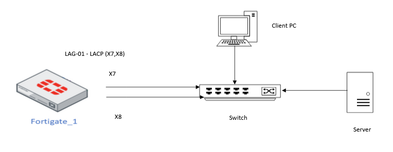

Description This article describes the issue where some or all Traffic on aggregate interfaces are affected on NP7 platforms.
Scope FortiGate NP7 platforms.
In this scenario, a client PC (20.0.0.1) on VLAN 352 sends an ICMP echo to the server (10.0.0.1) on VLAN 354.

Analyzing the sniffer, the FortiGate passes the traffic, and debugs show the same. On the switch side, when the packets were captured, the reply was seen, but the FortiGate did not see the same.
When the issue happens, some traffic may work, and some is affected, or all traffic on the aggregates is affected.
