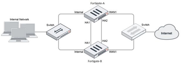

- Disconnect (all cables) from the HA cluster the Fortigate-B. (Secondary Fortigate with serial terminal FG-SERIALXXX_B).

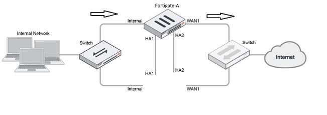

- Leave only the Fortigate-A connected (Active FortiGate with serial terminal FG-SERIALXXX_A). This equipment will remain operational to avoid service affectation. See Figure 1:
 Note: If the cables are not labeled, proceed to identify them to avoid confusion when reconnecting them later.
