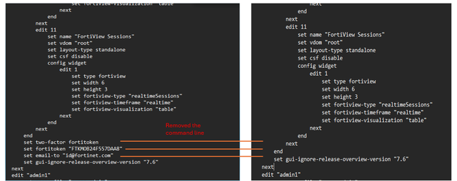

In any text-editing application such as notepad, go to the 'config system admin' section, confirm the admin account and remove the following line:
set two-factor Fortitoken set email-to "xxxx@fortinet.com"

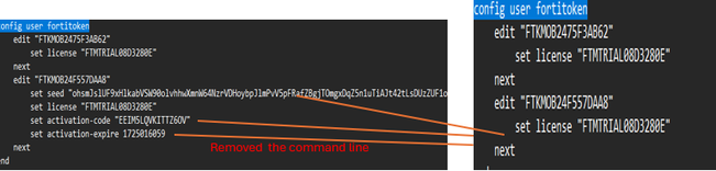

Next, go to 'config user fortitoken' and remove the following lines:
Remove the following lines:
set seed "xxxxx"
After removing these from both configuration settings, re-image with the same config backup file firmware version:
