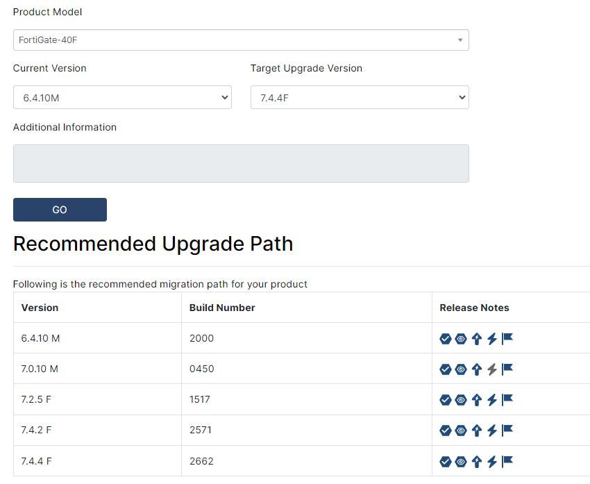

This article describes the issue when the firewall is not coming up while upgrading the firmware. This problem may happen if the upgrade path is not followed properly or any unwanted interruption during the upgrade process. Let's consider a firewall 40F is running on 6.4.10 and the target firmware is 7.4.4.
If checking in the upgrade path tool (Upgrade Tool), the path is:
Now if someone jumps directly from 6.4.10 to 7.4.4 skipping the other version, the firewall may not come up properly. |
