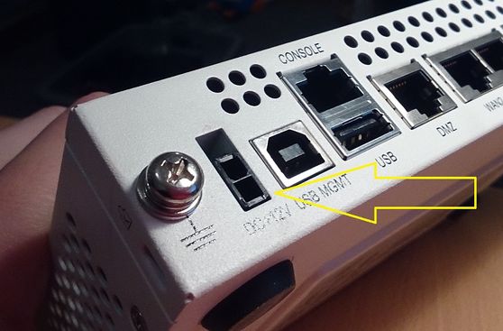

  1. Check Electrical Earthing:
  • Check the earthing connection for corrosion, loose connections, or damage.
  • Avoid using ungrounded or improperly wired power strips or extension cords.

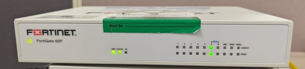

The following photo shows the LED status when the firewall is powered up and fully functional:

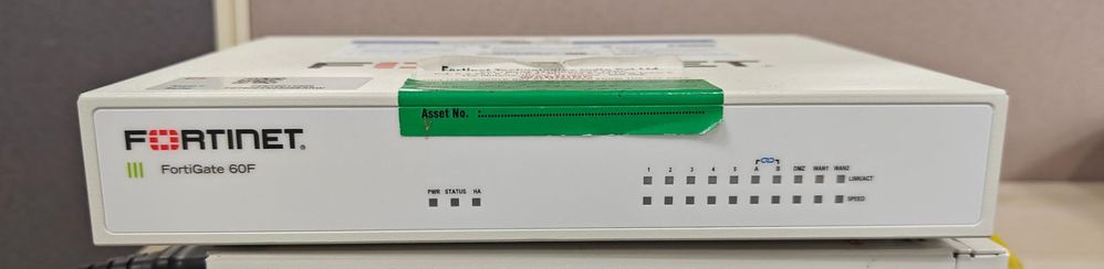

The following photo shows the LED status when the firewall is not functioning:
