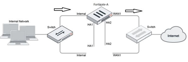

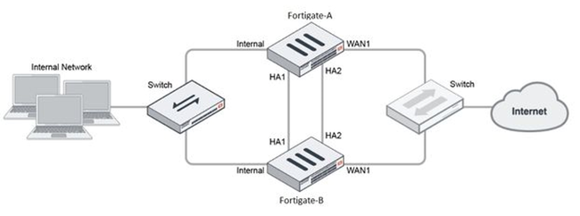

Procedure:
Note: If the cables are not labeled, proceed to identify them to avoid confusion when reconnecting them later.

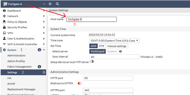

Note: If there is no access to the secondary member through the GUI, these changes must be performed through the serial console connection, but first the configuration must be restored using a TFTP server. More information in the following technical document: Technical Tip: Restoring a config file from the CLI by using TFTP server
config system global
config system ha
Check from the CLI that the changes have been accepted:
show full system global | grep hostname <- FortiGate-B should be the hostname. show full system ha | grep priority <- 100 should be the Priority.
If the units DO NOT sync, open a ticket with support and call support for immediate assistance.
