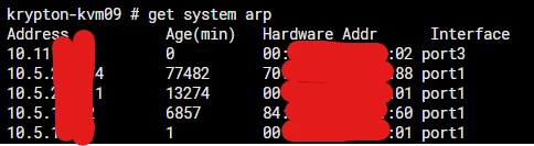

To filter only the MAC address learned by a single port:
get system arp | grep port1
Below is an explanation of the output:
Explanation:
  • Address: The IP address of the device within FortiGate’s network.
  • Age (min): The time (in minutes) since the ARP entry was last updated. ARP entries get updated as new traffic flows through the network.
  • 0: Indicates that the ARP entry is new or was just learned by the device.
  • Higher values: These indicate older entries, meaning the ARP entry was learned some time ago.
  • Hardware Addr (MAC Address): The MAC address of the device corresponding to the IP address.
  • Interface: The FortiGate interface (like port1, port3) through which the device is connected.
  • To get a particular interface Mac use the command  get system arp | grep port3.
