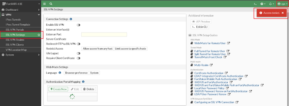

A user 'VPN' is applied with the Admin profile 'VPN' with only VPN Read/Write Access.
When the user 'VPN' tries to open the SSL- PN Settings on GUI, it is presented with an error 'Access Denied' even though the admin profile has Read/Write permission for VPN.

As seen in the above API calls, when the SSL VPN Settings page is loaded on the GUI, it makes a couple of API calls to resources in the system directory such as system.ddns and system.email-server.
Since the admin profile has None level access permissions to the System, the API calls fail thus causing the Access Denied error on the GUI.

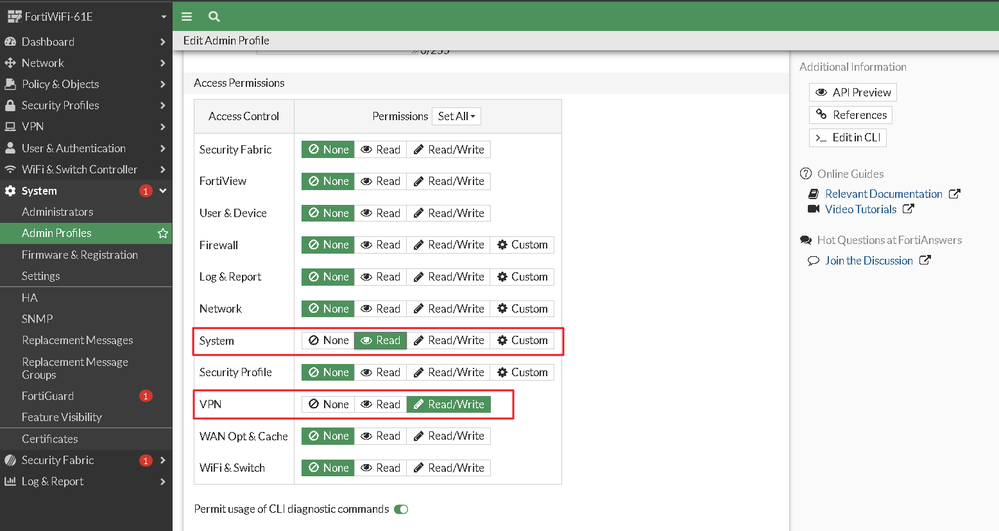

From the admin account with super_admin access privileges, enable at least Read-only access permission to the System in the admin profile, this will allow the API calls to be successful and allow the SSL VPN settings page to be displayed.
Navigate to System -> Admin Profiles -> Edit Profile- > Set System to Read.
Custom-level access permissions can also be used to only allow the required part of the System. At least Configuration needs to be set to Read as shown below:
