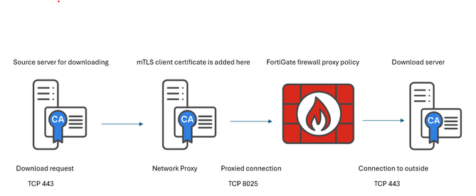

The topology below is an example of SSL inspection with a flow that uses mTLS. The FortiGate is set up as an explicit proxy receiving connection on port 8025 and sending out the request on port 443. FortiGate is configured to perform Deep Packet Inspection, the traffic flow uses mTLS and the certificate is verified by the remote download server.
The connection is performed from the download device to the FortiGate on port 8025.
1.1.1.1 --> 2.2.2.2.
The outside part is from FortiGate to the external system on port 443.
3.3.3.3 --> 4.4.4.4.
