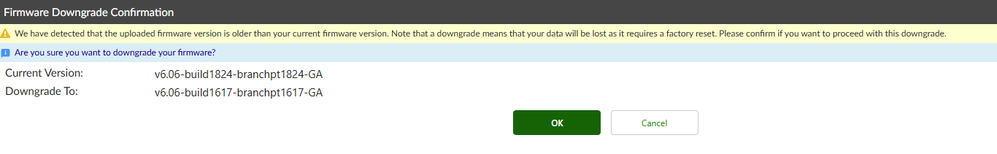

When uploading a firmware image with a lower version, the FortiAuthenticator will perform factory reset. The message below will be shown before the process proceeds:
The configuration backup must be from the same firmware version currently in use. It is not possible to restore a configuration backup from a different firmware version.
