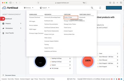

After logging into the web portal, select the '▼' icon, and select 'Create a Ticket'.

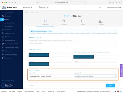

In the Customer Service section, select 'Submit Ticket'.
  • The serial number field can be left blank.
  • For Subject, enter a summary of the request. For Category, select 'CS Unit/Contract Transfer'.

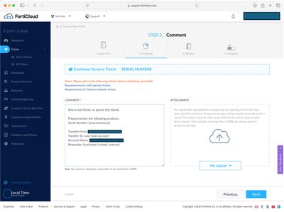

Enter the following message:
Transfer the product listed below:
Serial number: Serial number of the target device.
Transfer From: Source account name
Transfer To: Destination main account.
Requester: Customer's name, and account name.

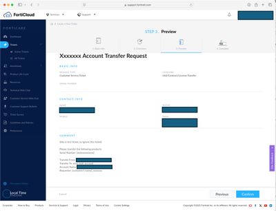

A confirmation screen will appear. Review the details and select 'Confirm'.
Once the 'Successful' message appears, the process is complete. Further communication will be received from the CS team shortly. Basically, the device transfer will be finalized once both the email address entered in 'Transfer to' and the email address entered in 'Transfer From' confirm the approval by replying via the ticket or by email.
