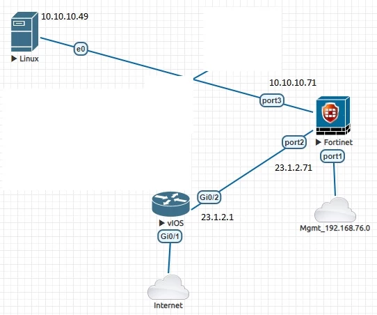

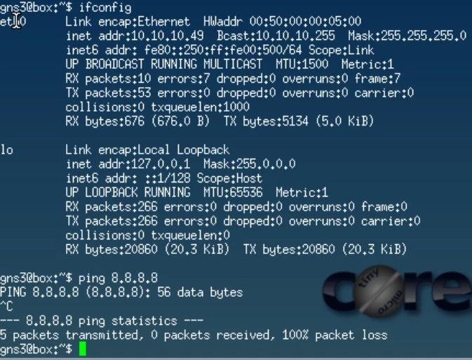

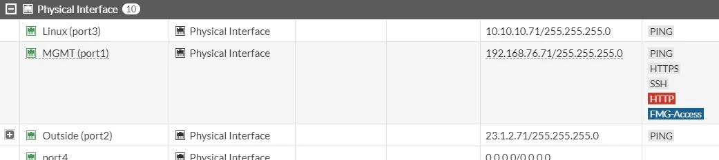

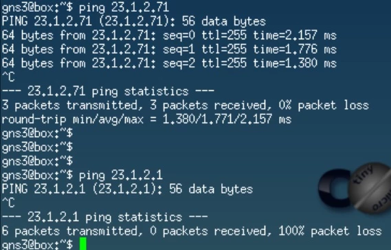

Hello, can someone take advice, why I cannot ping router interface and therefore internet from Linux?
Traceroute from Linux is useless -> no information

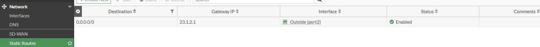

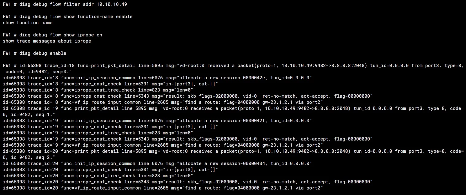

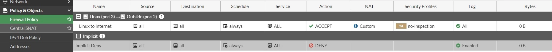

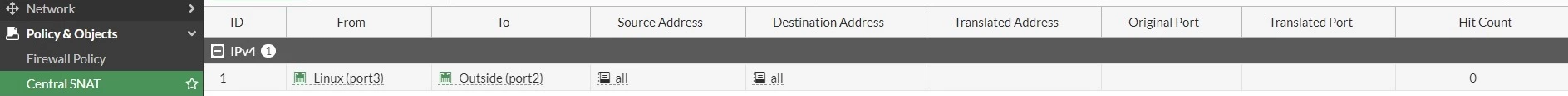

I have static default 0 route from FortiGate pointing to 23.1.2.1. I have policy from port 3 to port 2. And I have central SNAT from port 3 to port 2, where I translate to outgoing interface - no hit count.

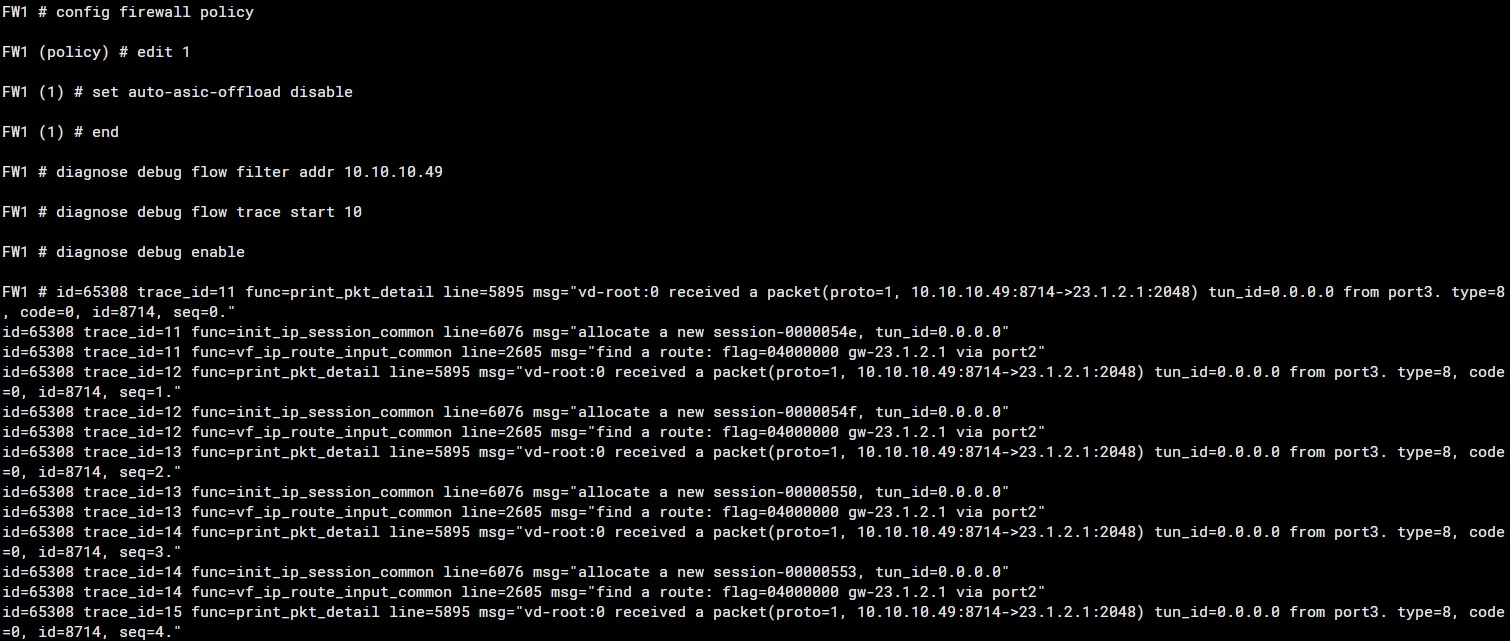

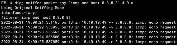

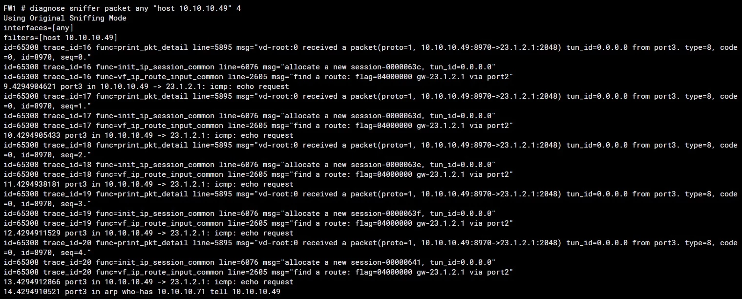

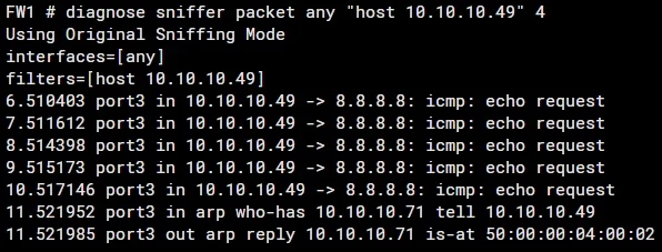

When I try to diagnose, I see only echo request and no echo reply. I dont know why. Any tip?
What is working is ping from Linux to fortigate:
10.10.10.49/24 ping to 10.10.10.71/24 -> ok
10.10.10.49/24 ping to 23.1.2.71/24 -> ok - policy take that traffic, I have some bytes

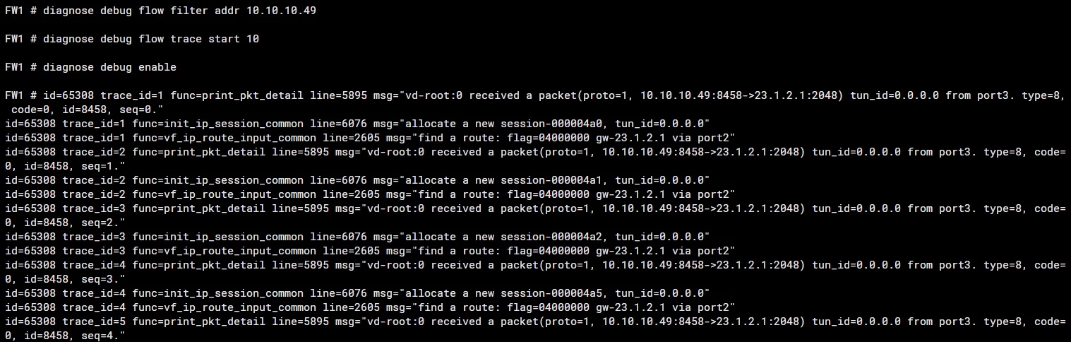

10.10.10.49 ping to 23.1.2.1 -> not ok - policy doesn't work, No more bytes
10.10.10.49 ping to 8.8.8.8 -> not ok

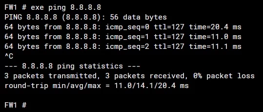

Also ping from Fortigate to internet 8.8.8.8 is working
FortiGate ping to 8.8.8.8 -> ok
Please help and bear with me. I am a new guy in Fortinet

Hi,
Can you rerun the debug flow with these two commands:
diag debug flow show func en
diag debug flow show iprope en?

Hi Adrian,
can you please tell me, how exactly should I type these commands. In which queue. Please bear with me, because I am new in Fortinet. I have typed commands like this. I don't know whether it is ok or don't. Please check output and let me know. Thank You

Hi Matie.
Please use the below-mentioned commands,
diag deb disable
diag deb reset
diag deb flow filter daddr x.x.x.x
diag deb flow filter proto 1
diag deb flow sh fun en
diag deb flow trace start 999
diag deb en
You can replace x.x.x.x with the destination IP and you can use any destination.
I suggest you to use 4.2.2.2, also please try to send 2 or 3 packets.
Kindly avoid continuous ping
