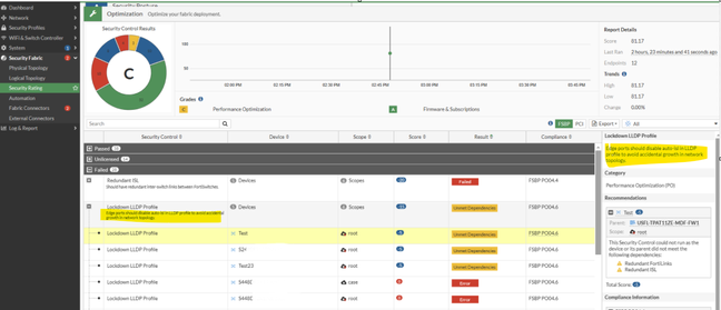

In the Security Rating section of the FortiGate GUI, an error or warning appears related to Lockdown LLDP Profile for FortiSwitch. This occurs when LLDP (Link Layer Discovery Protocol) profiles are not properly restricted, which may expose the network to accidental growth in network topology.

Once this change is done, the security rating will be set to 'passed'.
This can be achieved with the following command on FortiGate:
diagnose switch-controller switch-recommendation lock-down-topo-lldp-profile <fortilink interface name> <Serial number of the FortiSwitch>
