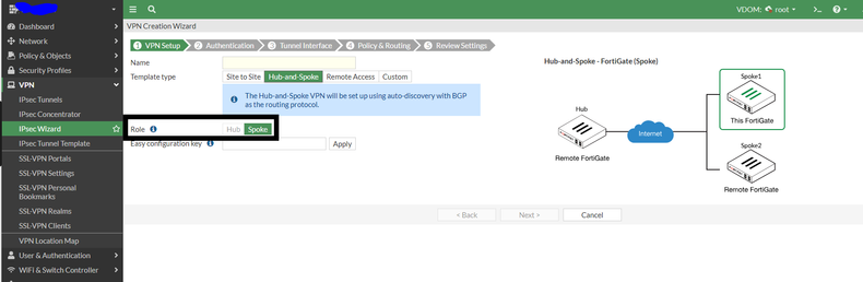

When creating an ADVPN IPsec tunnel from the IPsec wizard, the Hub role is greyed out:
The same device cannot be configured as a Hub and a Spoke, so when FortiGate is configured as a Spoke, the hub option is greyed out on the FortiGate wizard
sh vpn ipsec phase1-int | grep -B10 auto-discovery-receiver Example: Tunnel-made test is configured as spoken here:
