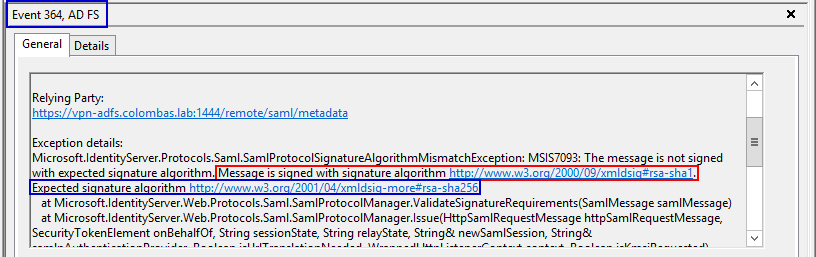

From ADFS Event Logs, an Event ID 364 will be recorded with the Exception below:
Exception details:
Microsoft.IdentityServer.Protocols.Saml.SamlProtocolSignatureAlgorithmMismatchException: MSIS7093:
The message is not signed with expected signature algorithm.
Message is signed with signature algorithm http://www.w3.org/2000/09/xmldsig#rsa-sha1.
Expected signature algorithm http://www.w3.org/2001/04/xmldsig-more#rsa-sha256.

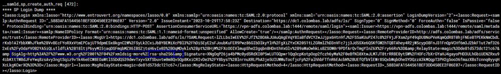

From FortiGate SAML debug log entries, the Signature Algorithm can also be found as the incorrect one being used.
SigAlg=http%3A%2F%2Fwww.w3.org%2F2000%2F09%2Fxmldsig%23rsa-sha1&
Which causes IdP to respond with the error message below.
__samld_sp_login_resp [826]: Failed to process response message. ret=-432(Status code is not success)

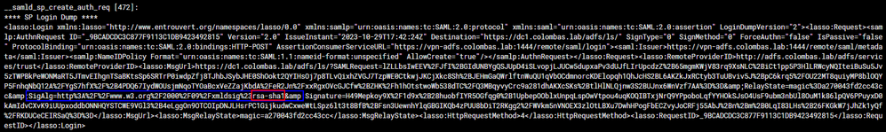

After the firmware upgrade to one of the versions that contain the fix, FortiGate signs the assertions with the SHA256 Algorithm as expected:
SigAlg=http%3A%2F%2Fwww.w3.org%2F2001%2F04%2Fxmldsig-more%23rsa-sha256&amp

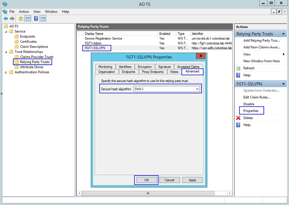

Workaround:
Configure the IdP Signature algorithm to accept assertions signed with SHA1 as per the ADFS example below.
Alternatively, a PowerShell command can be used by replacing '<RelyingParty_Name>' with the Relying Party name configured.
Get-AdfsRelyingPartyTrust <RelyingParty_Name> | set-AdfsRelyingPartyTrust -SignatureAlgorithm "http://www.w3.org/2000/09/xmldsig#rsa-sha1"
Relying on Party names can be retrieved with the command 'Get-AdfsRelyingPartyTrust | select Name'.
