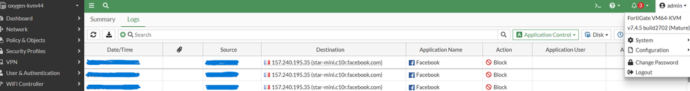

When the firewall policy is applied with application control and deep inspection is enabled in flow-based inspection mode, Facebook is blocked and the application blocked replacement page appears.
When the inspection mode is switched to proxy-based with deep inspection, the replacement page is no longer visible, instead showing the message 'ERR_CONNECTION_RESET' or a timeout.
The application was being identified correctly and the traffic was blocked as expected, and block logs were generated, but the application blocked replacement page did not appear, instead showing 'ERR_CONNECTION_RESET' or a timeout.

After upgrading to firmware v7.4.5, the expected replacement message is visible after switching the inspection mode to proxy-based with deep inspection.
