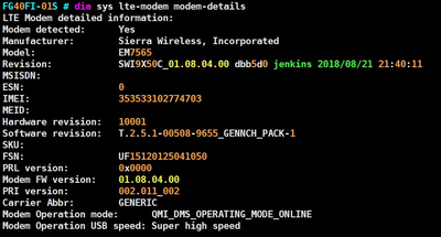

Verify the Parts from FortiGate with the command below. The parts will be for user EM75XX:
diagnose sys lte-mode modem-detail

Most FortiGate with LTE modem built-in with the version below, which can be found with the command 'diagnose sys lte-mode modem-details'.
In Revision Part:
In this example, the Firmware version will be SWI9X50C_01.08.04.00, and the latest firmware available from the above download link will be SWI9X50C_01.14.13.00 for the Linux version.

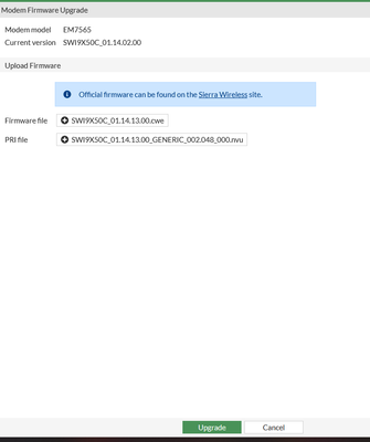

Access FortiGate via GUI. The upgrade can be done from Network-> System -> Interface, 'Double-click' the WWAN interface, at the right-hand side, select the upgrade button:
After selecting the Upgrade button, two files are required:
  1. Firmware File'.
  2. PRI file: select 'Browse' and navigate to the local computer, Firmware File extension will be 'cwe'. See below:
'Double-click' this file, 'browse' the second PRI file. At same extracted folders, it will be possible to find the extension 'nvu' file.
'Double-click':
Select 'Upgrade' at the bottom:
The upgrade will be started by itself. This upgrade will not cause a firewall reboot. However, it is recommended to do this action in the proper maintenance window for any unexpected behavior to roll back.
