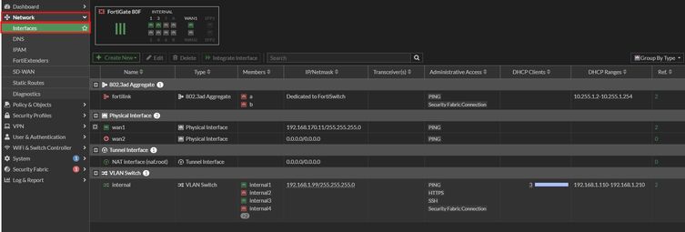

To create an aggregate interface, go to Network -> Interfaces:

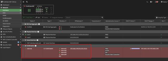

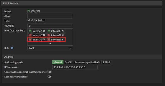

If the physical interfaces are members of a Hardware/Software/VLAN Switch, remove the desired ones from it:

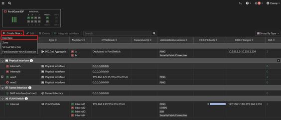

Once the physical interfaces are available, select Create New -> Interface:

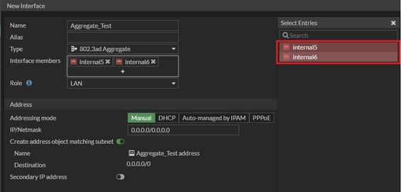

Set the type to '802.3ad aggregate' and add the members of it:

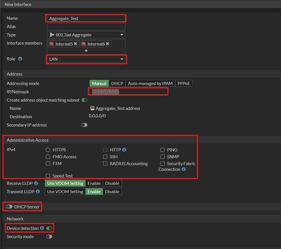

Set the necessary configurations for the interface like the name, Interface IP, Administrative Access, DHCP Server:

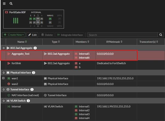

This will create the aggregate interface:
