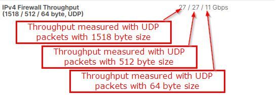

Firewall throughput is measured and displayed with three different UDP packet sizes since the Firewall performance can vary based on the packet size (smaller packets usually overwhelm the device hardware resources like RAM, and CPU, and the device performance measurements are lower when the traffic is comprised of smaller packets.). An example of the Firewall throughput measurement in the datasheet is displayed in the image below.
