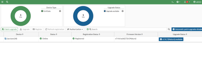

As shown in this image, the current firmware on FortiGate is v7.4.5.

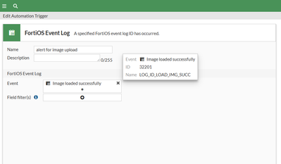

Create an automation trigger for FortiOS event logs.
Select the FortiOS event Log as the image loaded successfully with the correct log as shown in the screenshot.
