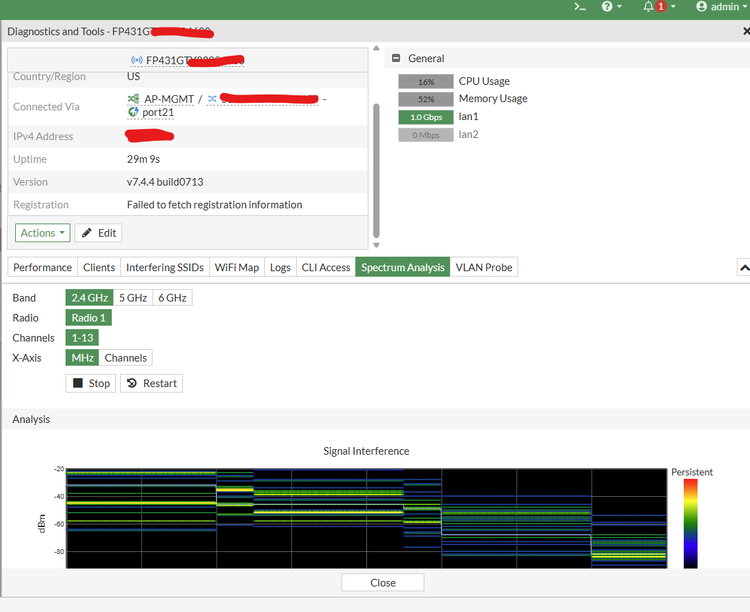

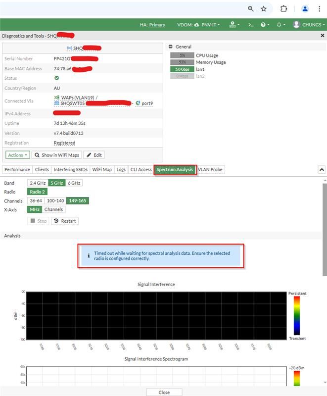

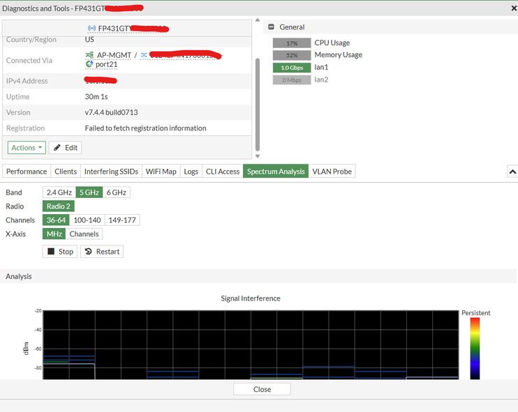

| Description | This article describes the issue when the Spectrum Analyzer is enabled on the FortiAP G-series profile on v7.2.10. |
| Scope | FortiOS v7.2.10, FortiAP-431G v7.4.4,build0713,241016 |
| Solution |
Workaround :
config wireless-controller wtp-profile
edit "FAP431G"
set ddscan enable
exec wireless-controller spectral-scan <fortiap serial number> 1 on
exec wireless-controller spectral-scan <fortiap serial number> 2 on
get wireless-controller spectral-info <fortiap serial number> 2
get wireless-controller spectral-info <fortiap serial number> 1
exec wireless-controller spectral-scan <fortiap serial number> 2 off
exec wireless-controller spectral-scan <fortiap serial number> 1 off

Resolution:
The issue is fixed in v7.4.x. The Spectrum Analysis data gets populated even when all Radios are enabled with Dedicated Monitoring.
