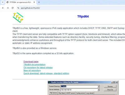

| Description | This article describes the steps to run the TFTP service in a Microsoft Windows Machine and using the TFTP server for the FortiADC firmware version CLI upgrade source host. |

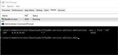

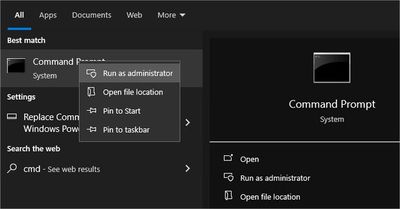

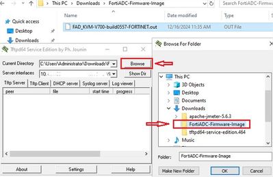

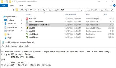

Prerequisite:

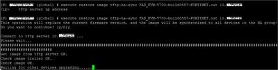

execute restore image tftp FAD_KVM-V700-buildXXXX-FORTINET.out 10.123.123.123
execute restore image tftp-ha-sync FAD_KVM-V700-buildXXXX-FORTINET.out 10.123.123.123
