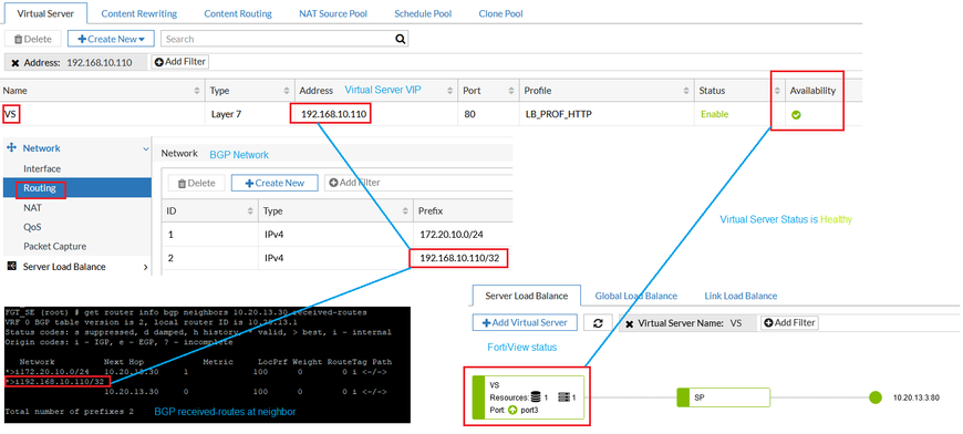

Route health injection (RHI) allows advertising routes for the Virtual Server IP (VIP) addresses based on the health status of the respective virtual server.
There is a requirement to advertise or remove the routes for the respective VIP addresses based on their health status to respective BGP neighbors.
1. Go to Network -> Routing -> BGP (tab).
From CLI:
config router bgp
Below example of when the VIP status is Dead (The respective VIP is not advertised by FortiADC):
