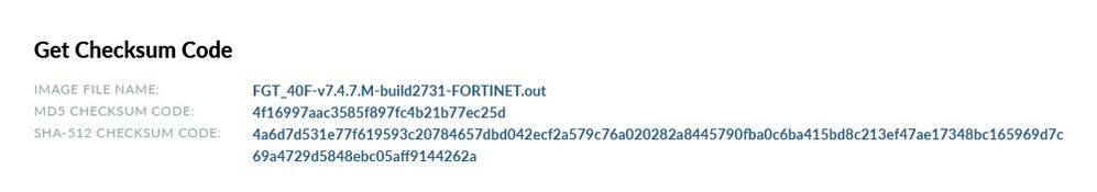

The SHA512 Hash above can be compared with the firmware download hashes verifying that the file is exactly the same and no download errors happened.
https://support.fortinet.com/Download/FirmwareImages.aspx

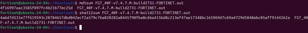

Linux.
To verify the file checksum in Linux the console can be used with the commands 'md5sum' and 'sha512sum'.
The syntax is:
md5sum <filename>
sha512sum <filename>
Example:
md5sum FGT_40F-v7.4.7.M-build2731-FORTINET.out
This can be compared to the checksum found on the FortiCloud support site.
