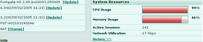

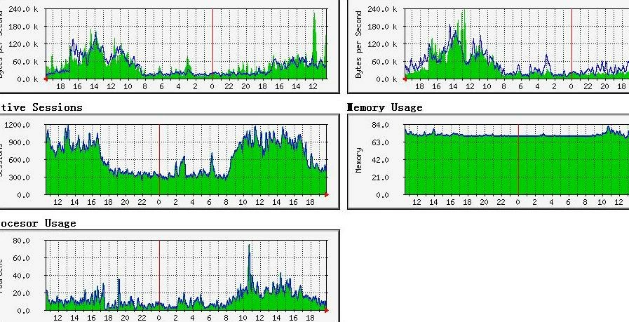

Hi , Engineers , I am facing a big trouble and suffering attack from boss. Can someone help to explain it ? High preciate for explanation . 1, I need to understand the effect to performance when I enable the IDS/IPS on the FortiGate60 . Had better to get an exact number . 2, On this FortiGate 60 , there are 20 direct VPN channels , and in this LAN , there are about 60 PCs and 10 servers. Enabled Anti-Spam,IDS,Anti-Virus,Web blocking . The external broadband bandwidth is 2Mbps . In working time , the memory utilization always more than 70% , even arrive at 85% . Sometimes , the CPU utilization may more than 90% . Pls refer to figures . 3, At this time , (CPU 99%,Memory 85%) , then the trouble come , I can' t access external network in this LAN , I can' t access the LAN from other offices through VPN channels , even ping any machines behind this FortiGate . just can https this FortiGate , I have to restart this FortiGate , then the utilization reduce , then I can access those equipments behind this FortiGate from other offices through VPN channels. 4, I urgently want to know the reason and solution . Why the memory and CPU is so highly , although my total bandwidth is just 2M , and FortiGate can support 70Mbps on firewall performance, 20M 3DES VPN performance , session 50,000 , VPN channel number 40 . From my implementation , every items is less than the maxim value , why my FortiGate encounter hanging up . My FortiGate , total outgoing bandwidth 2 Mbps , 20 VPN channels , maxim session 3000, why it cause so highly utilization , CPU 99%, Memory 85% . 5, How to estimate each features effect for permance and throughput , e.g. Anti-Spam , Anti-Virus etc.
