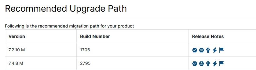

i got a brand new FGT and it got a default OS 7.4.8M.
i need to downgrade to 7.2.10M to be consistent in our environment.
per checking the upgrade path tool, it is a direct path.
since this is a brand new chassis with no config yet, can i safely downgrade directly from 7.4.8M > 7.2.10M?

Hi John
Yes you can, but the config may be corrupted after that, so you need to run factory reset after the downgrade.
On the other hand it is better to downgrade to 7.2.12, since 7.2.10 has a couple of nasty vulnerabilities.

https://docs.fortinet.com/document/fortimail/6.0.12/ga-release-notes/857090/firmware-upgrade-and-downgrade
But as per my knowledge it is also the same for FortiOS. This is because the upgrade path handles configuration transportation from a one version to a higher version (when following upgrade path), but this is not the case in downgrades.
It means when you downgrade you may have some config fragments that are not transported to the lower version and not known by this lower version, it means you may have some configuration errors.
Edit: As per my knowledge it is also the same for a new box, since even fresh config may have some config fragments that are specific to a version but unknown by a lower versions.

i just did a downgrade on a new FG 7.6 > 7.2, so far it's been doing ok.
i also did a config factory reset once it's on 7.2 just to be sure there will be no issue.
