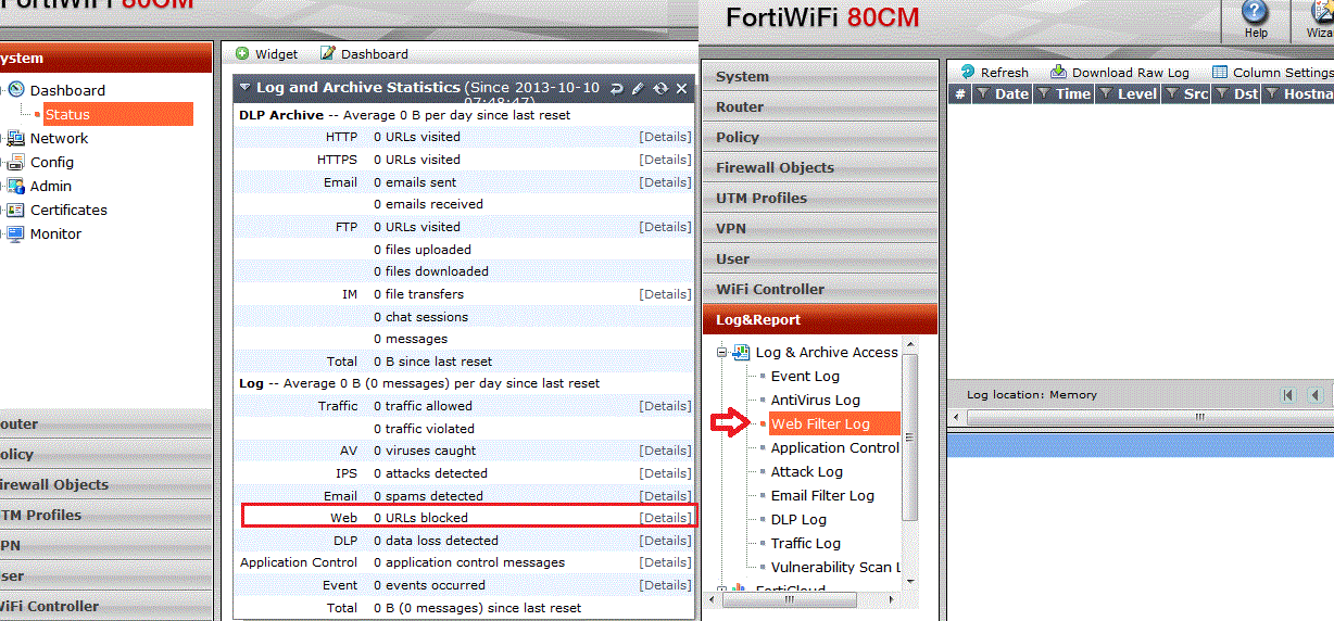

    Hi Stryker. The web site functionality may depend on other sites/domains. If you have logging enabled you should be able to check the blocked URLs (under the Log and Archive Statistics widget) or the Web Filter log under " Log&Report" . Add any " missed" urls to your URL or Local ratings category. (You may want to play around with " Allow Websites When a Rating Error Occurs" , " Strict Blocking" , or " Block HTTP redirects by Rating" options in your web filter Profile to see if that makes a difference.) The attached screen shot is from 4.0 MR3 patch 14. You did not indicate which firmware your fgt device is running.

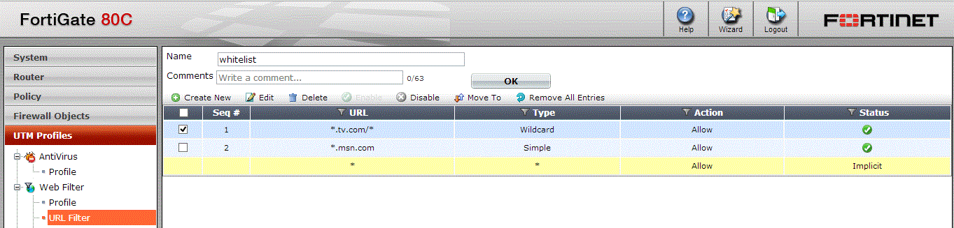

    You have to use URL Filters I suggest you use *.facebook.com/* in Wildcard Mode [Not Simple Mode] as block. Then use www.facecook.com/radiowave in Simple Mode as allow. Allow should take precedence over block.

    Hello, I have web filtering enabled and it blocks the sites by category fine. but i want to unblocked one of the blocked sites. I have added it to URL Filter to keep it from blocking, but doesnt work.
    Dave_Hall
    July 30, 2013
    ORIGINAL: Faaeq I have added it to URL Filter to keep it from blocking, but doesnt work.
    Try changing the type to regex and set the URLs (using your example) to " .*\.msn\.com.*" and " .*\.tv\.com.*" (without the quotes). If that does not work, try setting the URL to " msn.com" and " tv.com" (leave the type at reqex). If app control is enabled on the fw policy, you may want to check that app control to see nothing in it is blocking the sites in question. An alternate way to " allow" a website through FortiGuard web filtering is to use the Ratings Override to reclassify the web site (in question) to a category that is already allowed through the firewall.

    We are running 5.0 build 179 (GA patch2). So I can get to pinterest.com but not this specific URL: http://www.pinterest.com/montessorimom/education-ideas/ I checked the logs and this URL never shows up. My version looks a little different than yours. I do not have Log&Archive Access in my Logs section. I also tried to add the widget you have for the dashboard and it' s not available.
    Devendra_Palan
    October 15, 2013
    Hi Stryker, In V5.0 Under log&Reports check in security logs for the web filtering logs. Also check in forwarded traffic logs for packet info. Pls cross verify the rating override config with the particular URL.
