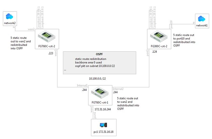

Diagram
Expectations, Requirements
Requirements
Only the FGT60C-crt-1 is used to test the PBR’s behavior, while FGT60C-crt-2 and FGT300C are used as two common routers.
Please note that FGT60C-crt-1 is physically connected to the other devices using two internal ports on same vlan.
L3 Connectivity:
FGT60C-crt-1 has only one IP configured in the Internal ports (the two internal ports are running as switch port).
Moreover, all three devices run OSPF and have 5 static routes each redistributed on OSPF.
The two external devices have a route to the same IP using a loopback.
FGT60C-crt-1 sees the common IP loopback (20.0.0.1) through the OSPF redistribution and by default, it elects in its routing table the one from the FGT60C-crt-2.

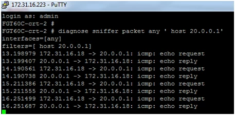

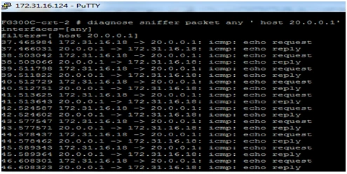

Check, if the ping changes the path from the default next hop (FGT60C-crt-2) to the second one (FG300C-crt-2) just by disabling the Loopback on FGT60C-crt-2
Before disabling the Loopback on FGT60C-crt-2:
 After disabling the Loopback on FGT60C-crt-2:

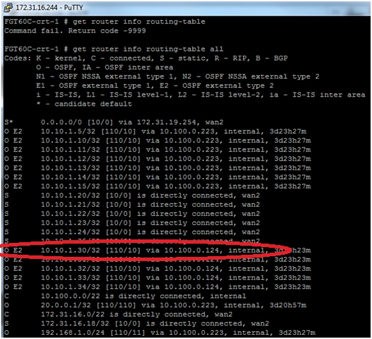

Before applying the changes:
After applying the PBR on the FGT60C-crt-1:
The route in routing table for 20.0.0.1 is still pointing to the FG300C-crt-2 (see route for 20.0.0.1 below)
NOTE: The gateway (10.10.1.30) is the static route behind the FG300C-crt-2
