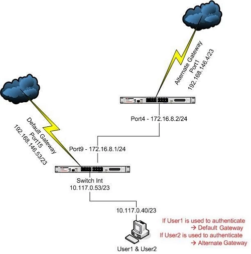

Authentication-Based Routing allows the creation of an identity-based route that associates a user group with one or more routes. This is currently only configurable via the CLI.
It is useful for MSSPs that need to route users from different organization to different Internet gateways and it works with Local or Remote Authentication.
It should be noted that this feature is only available when Identity-based Policy is enabled.
FortiGate v5.0 and above
Configuration Example

3. Configure an Identity-based Routing entry. A sample configuration for creating an Identity Based Route is given below:
config firewall identity-based-route
edit "alternate-route"
config rule
set gateway 172.16.8.2
set device "port9"
set groups "test1" "test2"

5. Create another firewall policy to allow traffic to flow out to the alternate gateway:
set srcintf "switch"
set dstintf "port9"
set srcaddr "all"
set dstaddr "all"
set service "ANY"
set device-visibility enable
set user-visibility enable
set nat enable

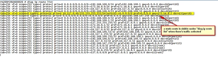

4. Run a "diag ip route list", if configured correctly and when there is active traffic hitting the authentication-based routing, an entry as shown below should be seen:
