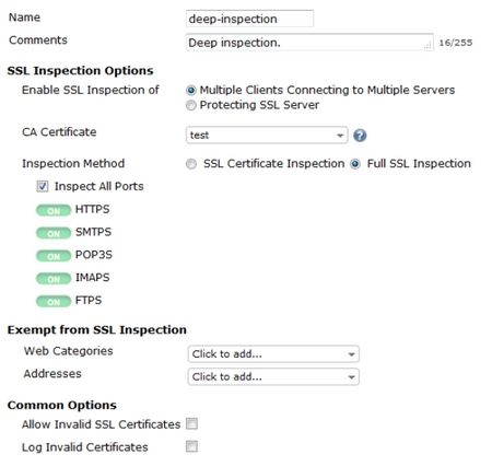

openssl req -new -x509 -days 3650 -keyout private/cakey.pem \ -out cacert.pem -config /etc/ssl/openssl.cnfcacert.pem is the public key and should be imported into the FortiGate and the user browser.
openssl ca -out test.cer -infiles /root/Downloads/ test.csr4. Import the signed certificate (test.cer) into the FortiGate as “local certificate”.
