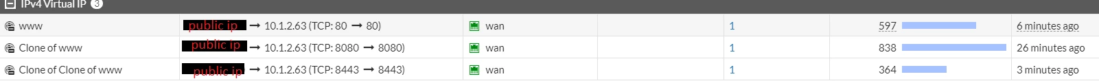

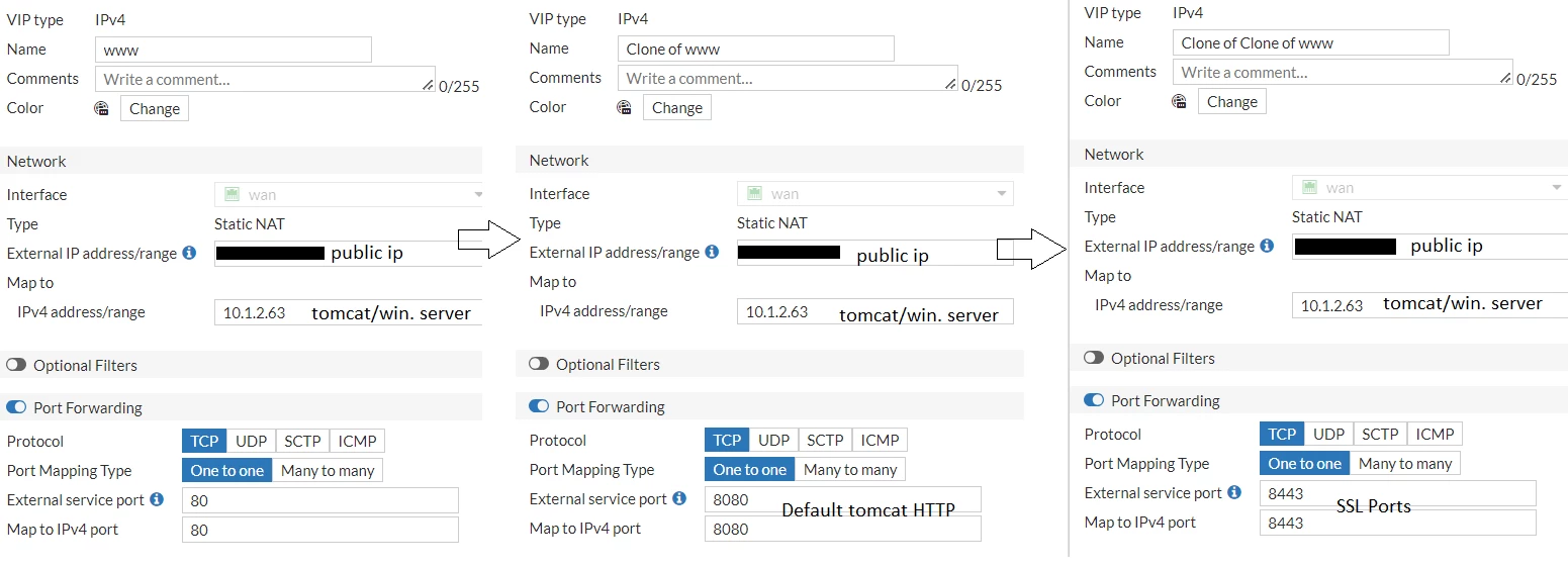

I've added 2 VIP's one for port 80 and one for port 8443(https) - port 8443 seems to get hits, but cant load, and port 8443 reports as closed when using tools to check for open ports.

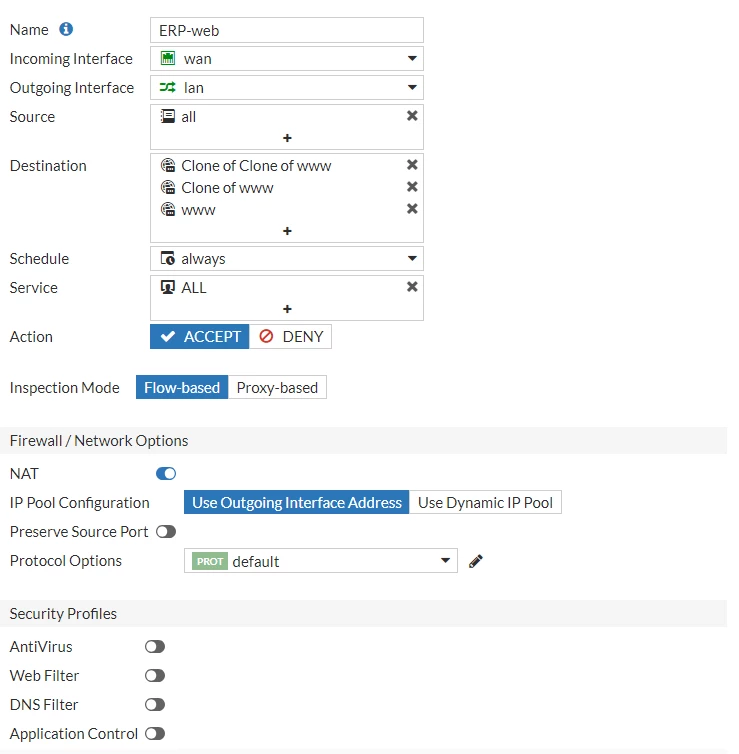

I've attached some screenshots of my vip's and firewall policies (im guessing the issue might be within the firewall rules, as im a complete newbie at this).
I've attached 2 screenshots - 1 of the vip settings, and other of the firewall rule. I would greatly appreciate if someone more experienced could point be to the right direction, i've fought this for 3 days without any luck.

At a glance the setup looks OK. Here's a list of semi-random points that may be worth checking:
  • Does "domain.com" resolve to the WAN interface IP, exclusively? (not resolving to two IPs, or giving multiple results rotated in round-robin fashion)
  • Is the mapped-ip 10.1.2.63 actually reachable via the "lan" interface? (is "lan" in the same subnet? Or does it at least have a route towards the IP via another router?)
  • You wrote "localhost:8443". Is the server configured correctly? A) is it listening on its ethernet interface connected to the 10.1.2.63/xx subnet? B) Is the local firewall (if any is enabled) on the server allowing incoming traffic to TCP/8443?
  • Is the server application configured with any source-ip restrictions for incoming connections? (less likely to be relevant with SNAT enabled in the FGT firewall policy, but it may become more relevant later)
