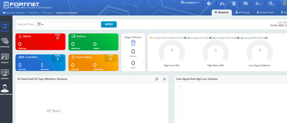

Sent: Oct 21, 2022 03:02 AM
From: Matti Matti
Subject: FortiWLM / MERU Virtual controller image
Hello Colin,
thank you so much for your professional speculations, you are the man. Just adding this second disk solved it. This is a day of joy, but APs are not showing up, in the very end of this story.
Br Matti

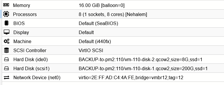

2) create a VM without any disks or CD's in Proxmox (settings below), ID for example not used number 212 (needed in importdisk command)
3) go to Proxmox terminal and directory where image is downloaded
qm importdisk 212 forti-wlm-8.6-4build-6-x86_64.img your-storage-name-that-supports-images --format qcow2​
4) go to Proxmox GUI, and see if disk is showing up as "unused" under VM 212, double click it and make it ide0
5) in Proxmox GUI again, under VM 212, add --> hard disk --> and add as Colin pointed out SCSI disk, size 200Gb or such
6) check from Proxmox GUI --> VM 212 --> Options that in the boot order the first is IDE0
7) under VM 212, top right select "Console" and power on, see what happens
8) rest is configuring FortiWLM VM
1) VM settings as below, as there is a VLAN tag 12 on the last line. Tagging or untagging VLAN works, if untagged here, also at the switch must be untagged naturally.

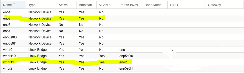

2) this is how it looks at the node level, eno2 is connected to HP switch physically, and a linux brigde vmbr12 is created on it, VLAN aware enabled.

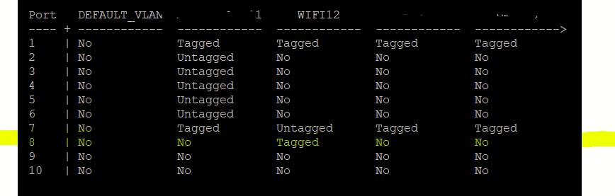

3) HP switch looks like this, port number 8 is connected to VLAN 12
The next issue is, that AP832e's are not showing up to controller, even if they are connected to the same VLAN 12 untagged. They get IP address (pingable also from controller's IP), DHCP option 43 is pointing to controller (not necessary because of same VLAN), NTP is pointing to same source etc.

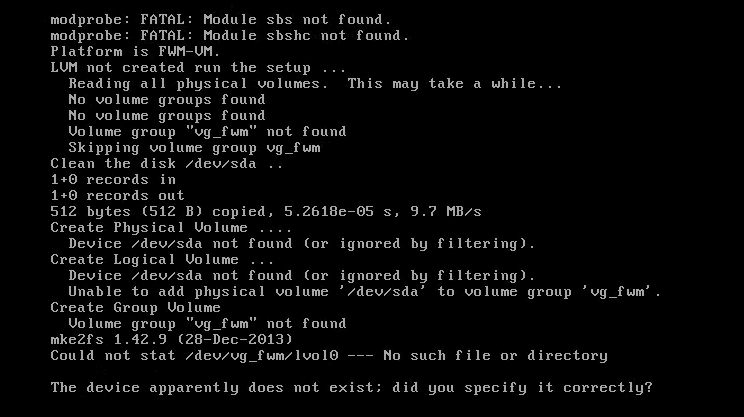

Hi Matti
Speculating here a little, but maybe this might be due to lack of second hard disk?. Please check out the WLM admin guide from p504 onwards
https://fortinetweb.s3.amazonaws.com/docs.fortinet.com/v2/attachments/59847c6b-07f2-11ed-bb32-fa163e15d75b/FortiWLM_8.6.4_UserGuide.pdf

Hello all,
I'm desperate need of help, I have purchased a FortiWLM virtual controller, downloaded the latest 8.6-4 versions and couple of previous ones as well. There is something missing in the deployment guide, because with those instructions, Virtual Controller ends up to a boot loop, no matter what is the virtualisation platform Hyper-V, Proxmox, KVM or Virtualbox. (Other option is that I'm stupid, not to get it myself.)
If someone has any contribution of this FortiWLM virtual image play around, hint what needs to be done in order to get it run, I would appreciate if you would share it. Or would anyone of you have a MC4200 Virtual controller image?
Picture just before boot ends and a new loop starts.
Br Matti
