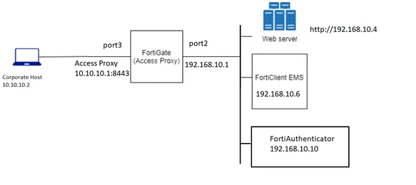

The environment used for this case:
ZTNA flow with SAML authentication:

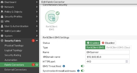

Step 1: Configure the Fabric Connection FGT <-> FortiClient EMS.
EMS configuration.
Go to System Settings -> EMS settings:
Webserver Certificate - This is the server certificate identifying FortiClient EMS for HTTPS access and Fabric connection.
EMS CA Certificate (ZTNA) - This is the CA certificate that FortiClient EMS uses to generate Client Certificates with FortiClient ID, which are sent to FortiGate for Device verification.
FortiGate Config.
In FortiGate go to Security Fabric -> Fabric Connectors and add the FortiClient EMS IP.
The administrator will be prompted to authorize the integration with FortiClient EMS on FortiGate.
CLI config:
config endpoint-control fctems
        set status enable
        set name "EMSserver"
        set server "192.168.10.6"
        set serial-number "FCTEMS********"
        set capabilities fabric-auth silent-approval websocket websocket-malware push-ca-certs common-tags-api
        set ca-cn-info "OU = global.lab.net, CN = global.lab.netEMSserver.Domain1.local"

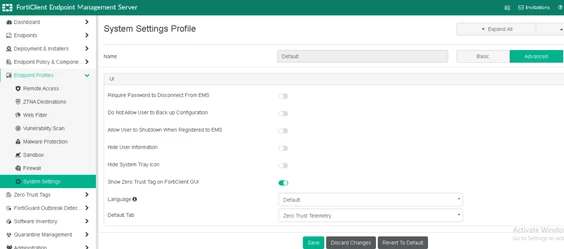

To check what TAGs are the Endpoint matching it is necessary to enable the following option in FortiClient EMS:
Go to Endpoint Profiles -> System Settings -> Edit the Default profile.
Enable 'Show Zero Trust Tag on FortiClient GUI'.
Validate the host matches the Corporate Host Tag by selecting the Username on the top left in the FortiClient Dashboard:

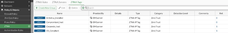

Validate that Zero trust Tags are being synced in FortiGate.
Go to Policy & Objects -> ZTNA -> ZTNA Tags (The ZTNA feature must be enabled in System -> Feature Visibility in order to appear on the GUI).
  • When the FortiGate establishes a connection with the FortiClient EMS server via the EMS Fabric connector, it pulls zero-trust tags containing device IP and MAC addresses and converts them to read-only dynamic address objects.
  • It also establishes a persistent WebSocket connection to monitor for changes in zero-trust tags, which keeps the device information current.
See Synchronizing FortiClient ZTNA tags - FortiGate administration guide.

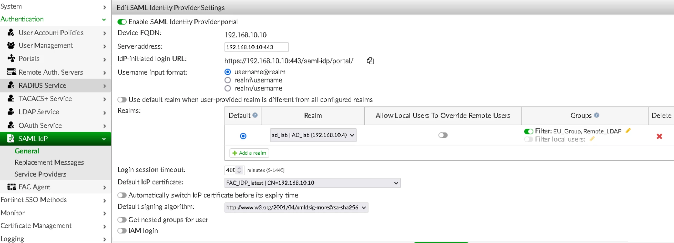

Go to Authentication -> SAML IDP -> General.
Configure the relevant AD realm where the remote LDAP user is part of and filter for the groups.
Add the newly created IDP certificate.
Leave other settings as default and save.

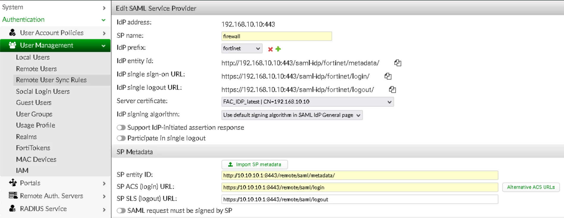

Go to Authentication -> SAML IDP -> Service Providers.
Complete the SAML SP configuration:

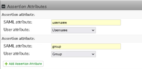

Add the following attributes to match user information that will be sent to the SP:

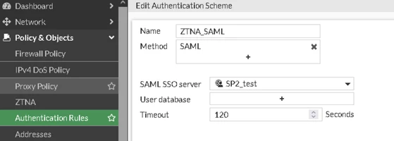

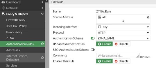

Create the Authentication Scheme, Rule, and authentication settings:
Go to Policy & Objects -> Authentication Rules and select Authentication Scheme on the top right:
Configure the Authentication Scheme by selecting the SAML method and referencing the SAML instance created previously.
CLI configuration:
config authentication scheme
    edit "ZTNA_SAML"
        set method saml
        set saml-server "SP2_test"
Configure the Authentication Rule:
From v7.6.3, the Policy & Objects -> Authentication Rules page has been renamed Policy & Objects -> Authentication.
CLI configuration:
config authentication rule
    edit "ZTNA_Rule"
        set srcintf "any"
        set srcaddr "all"
        set active-auth-method "ZTNA_SAML"

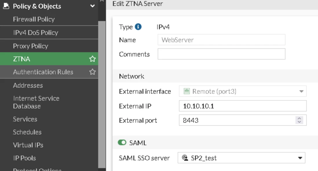

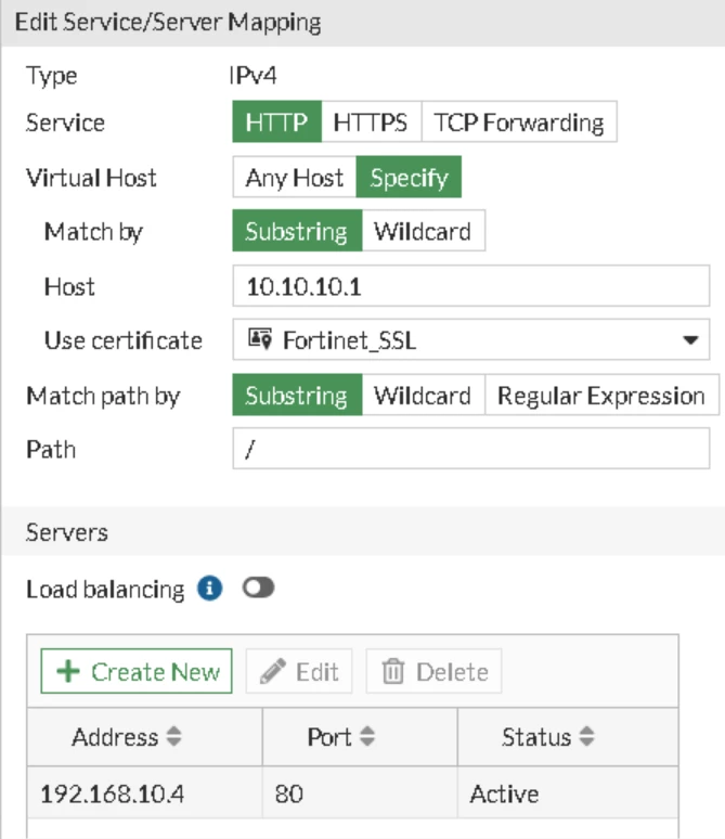

Configure the ZTNA Server and ZTNA rule.
Go to Policy&Objects -> ZTNA.
Create the ZTNA Server:
Add a Server/service mapping:
CLI config:
   config firewall vip
      edit "WebServer"
            set type access-proxy
            set extip 10.10.10.1
            set extintf "any"
            set server-type https
            set extport 8443
            set ssl-certificate "Fortinet_CA_SSL"
( Or the certificate being used. )
config firewall access-proxy
    edit "WebServer"
        set vip "WebServer"
        set client-cert enable
            config api-gateway
                    set service HTTP
                        config realservers
                                set ip 192.168.10.4
                                set port 80
                    set service samlsp

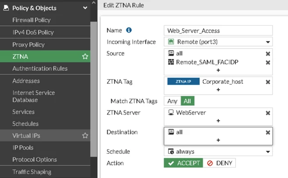

Configure the ZTNA rule:
Leave other settings as default.
CLI config:
config firewall proxy-policy
        set uuid e83fb0c6-0066-51ee-965e-7f0f97862e74
        set name "Web_Server_Access"
        set proxy access-proxy
        set access-proxy "WebServer"
        set srcintf "port3"
        set srcaddr "all"
        set dstaddr "all"
        set ztna-ems-tag "EMS1_ZTNA_Corporate_host"
        set ztna-tags-match-logic and
        set logtraffic all
        set groups "Remote_SAML_FACIDP"

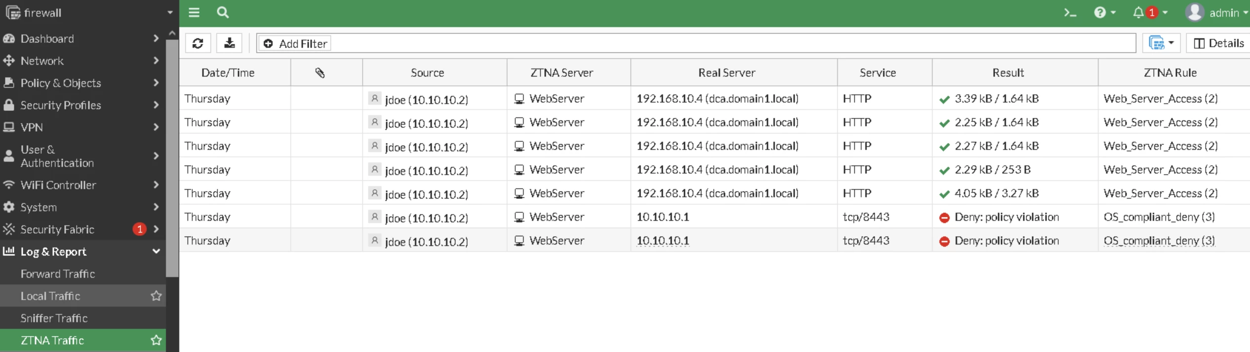

Step 5: Validation and Debugging.
To troubleshoot similar cases, it is necessary to enable the below debugs in FortiGate CLI:
diagnose debug reset
diagnose debug application samld -1
diagnose wad debug enable category all
diagnose wad debug enable level verbose
diagnose debug enable
To stop the debugs:
     diagnose debug disable

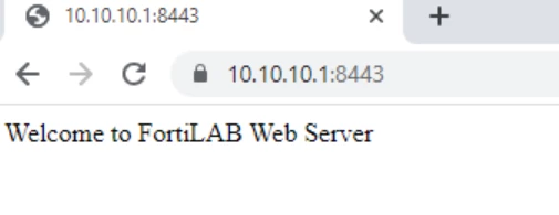

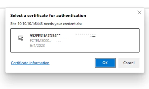

When accessing the protected web page, the browser will first be prompted by FortiGate to present a client certificate. This is the certificate issued to the device by the EMS ZTNA CA.
Select the appropriate certificate and then select OK to proceed.
At this point, FortiGate will perform a device identity check by validating the Client certificate and also performing a posture check (ZTNA tag matching).
Relevant events:
[p:229][s:5018004] wad_vs_ssl_access_proxy_on_clt_certs:11991 1:WebServer: cert cache cert(0x7f2ef4d80bf8) authi(0x
[p:229][s:5018004] wad_vs_ssl_access_proxy_on_clt_certs:11996 1:WebServer: vs, Found the cert, and issued by:ems
[p:229][s:5018004] wad_vs_ssl_access_proxy_on_clt_certs:12001 1:WebServer: hit the cached auth_result(7)
[p:229][s:5018004] wad_vs_ssl_access_proxy_on_clt_certs:12035 1:WebServer: Cert auth success. issued_by: ems
[V][p:229][s:11405486][r:51] wad_dev_addr_match :282 conf tag name:EMS1_ZTNA_Corporate_host(24) matched, id = 4, tag_index = 5!
[I][p:229][s:11405486][r:51] wad_auth_rule_match :1260 match auth rule succ: ZTNA_Rule
[I][p:229][s:11405486][r:51] wad_http_req_get_user :10437 process=229 auth-rule=ZTNA_Rule user=/0/0 ip-based/auth-cookie/transact=1/0/0 tp_proxy_auth=1 auth_req=(nil) auth_line=(nil)
[V][p:229][s:11405705][r:53] wad_dev_addr_match :282 conf tag name:EMS1_ZTNA_Corporate_host(24) matched, id = 4, tag_index = 5!
[I][p:229][s:11405705][r:53] wad_auth_rule_match :1260 match auth rule succ: ZTNA_Rule
[I][p:229][s:11405705][r:53] wad_http_req_get_user :10437 process=229 auth-rule=ZTNA_Rule user=/0/0 ip-based/auth-cookie/transact=1/0/0 tp_proxy_auth=1 auth_req=(nil) auth_line=(nil)

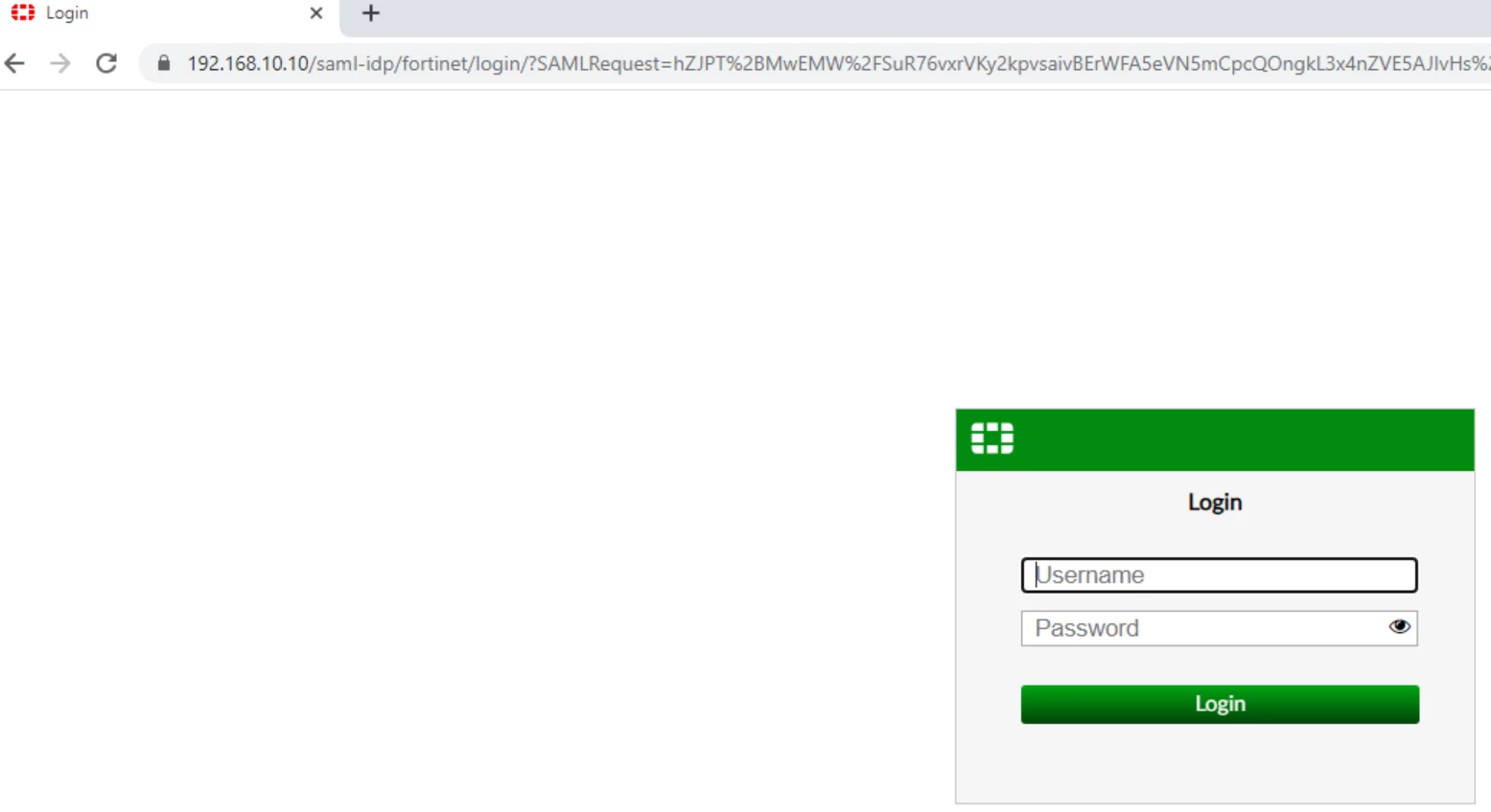

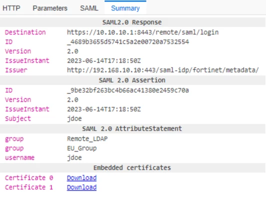

If this step is successful, FortiGate will then redirect the client to the FortiAuthenticator IdP for authentication.
[[V][p:229] saml_ipc_on_read :268 Rcvd 12511 bytes from SAMLD: rc=0
[V][p:229] hauth_saml_aqueue_key_hash :2229 called
[V][p:229] hauth_saml_on_notify :1254 called
[V][p:229] hauth_saml_on_notify :1319 called
[V][p:229] hauth_saml_grpinfo_parse :1201 SAML RESP: attr 'group' = 'Remote_LDAP'
[I][p:229] hauth_saml_grpinfo_append :1183 Realloc grp inform size to 8192
[I][p:229] hauth_saml_grpinfo_append :1188 Append group info: 'Remote_LDAP'
[V][p:229] hauth_saml_grpinfo_parse :1201 SAML RESP: attr 'group' = 'EU_Group'
[I][p:229] hauth_saml_grpinfo_append :1188 Append group info: 'EU_Group'
[V][p:229] hauth_saml_grpinfo_parse :1201 SAML RESP: attr 'username' = 'jdoe'
[I][p:229] hauth_saml_grpinfo_append :1188 Append group info: 'jdoe'
[V][p:229] hauth_saml_resume_request :590 called
[V][p:229] hauth_saml_resume_request :683 called
[V][p:229] hauth_saml_process_usergrp :1659 called
[V][p:229] hauth_saml_activate_saml_user :962 called
[V][p:229] hauth_saml_activate_saml_user :964 Activate user 'jdoe' ses/vd: 0x7f2ef34c38b8/0x7f2ef37ce010
[V][p:229] hauth_saml_make_ms_from_grpinfo :913 server=SP2_test grp=EU_Group
[V][p:229] hauth_saml_make_ms_from_grpinfo :913 server=SP2_test grp=jdoe
[I][p:229] wad_http_auth_update_user_ext2 :2762 updating user. ip: 10.10.10.2, type:IP
[I][p:229] wad_auth_inc_user_count :1677 increased user count, quota:128000, n_shared_user:1, vd_used: 1, vd_max: 0, vd_gurantee: 0
[V][p:229] __wad_hauth_user_node_hold :2128 wad_hauth_user_node_alloc (1579): holding node 0x7f2ef35a3088
[V][p:229] __wad_hauth_user_node_hold :2128 wad_http_auth_use_user_node (2692): holding node 0x7f2ef35a3088
[V][p:229] __wad_hauth_user_node_put :2139 wad_http_auth_use_user_node (2693): putting node(ref=1) 0x7f2ef35a3088
mapping user_node:0x7f2ef35a3088, user_ip:0x7f2ef3581cf8(0), user:0x7f2ef351cc48(0)
[V][p:229] __wad_hauth_user_node_hold :2128 wad_http_auth_update_user_ext2 (2982): holding node 0x7f2ef35a3088
[V][p:229] hauth_saml_activate_saml_user :997 Update authenticated SAML user 'jdoe' cfg 'SP2_test' Success

Using the SAML tracer plugin, it is possible to double-check the expected Assertions sent in the SAML response from IDP to SP:
After successful authentication, the user will be redirected to the Web Server:

For testing purposes, other TAGs have been included to match this host in order to deny access for specific TAGs.
In Log&Report -> ZTNA traffic, it is possible to check the matching Rules and actions:

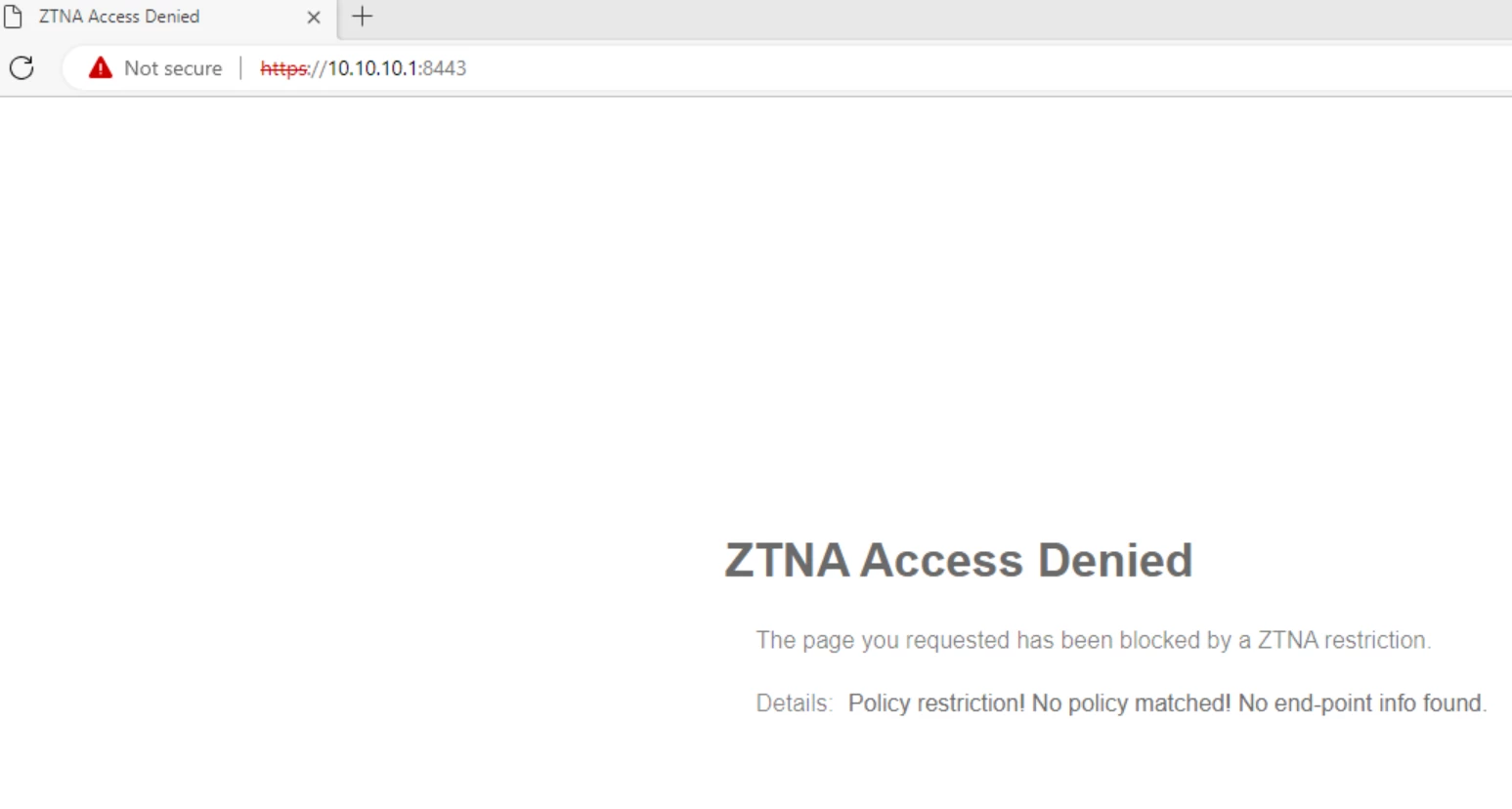

Corporate Host gets disconnected from ZTNA trust Telemetry:
In such cases, the Host will lose the Corporate Tag previously assigned and it will be denied access to the protected resource.
Debug events for such cases would be the following:
[V][p:216] wad_informer_proc_dev_query :1636 Didn't find the record using dev_find, Forwarding request to EMS.
[V][p:216] wad_inform_dev_get_from_ems :1324 Request EMS to search with uid value XXXXXXXXX and sn value YYYYYYYYYYYYY.
[V][p:216] wad_inform_dev_create_intermediate_node:734 uid=XXXXXXXXX sn=YYYYYYYYYYYYY
[V][p:216] wad_inform_dev_query_req_open :706 dev 0x7f346b052048 has newly added query conn 0x7f346b1a2048.
[V][p:216] wad_informer_proc_dev_query :1669 hold request for further processing as no record found!.
[V][p:216] wad_inform_dev_query_expiry :818 No content returned for request 5.
[V][p:216] wad_inform_msg_hdr_get :580 msg=DevQueryResp code=NoEntry seq=5
[V][p:229] wad_authenticated_user_proc_msg_header:1447 msg=DevQueryResp code=NoEntry seq=5 data_len=0
[W][p:229] wad_dev_resp_proc :4311 dev resp is nok:1
[V][p:229] wad_dev_query_cb :4163 dev resp tid=0, rsp=(nil)
[W][p:229] wad_dev_query_cb :4169 vf_id=0,dev:cert:393532464533313141374435344231334241424641374538323732333939423200464354454d533030303031323030363700 is not found
[V][p:229] wad_fw_policy_match_dev_grp :4941 dev tag matching, info=(nil), tag_cnt=0, on_line=0,conf ems-tag size=1
[V][p:229] wad_fw_policy_match_dev :5012 pol_id = 2 matched = 0
[V][p:229][s:11314136][r:31] wad_http_req_policy_notify :9649 notify policy match: req=0x7f2ef382b5a8 status=1 pid=229.
[I][p:229][s:11314136][r:31] wad_http_req_policy_set :9435 match pid=229 policy-id=0 vd=0 in_if=5, out_if=4 10.10.10.2:58318 -> 192.168.10.4:80
[E][p:229][s:11314136][r:31] wad_http_req_proc_policy :9169 POLICY DENIED
