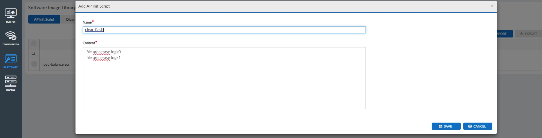

Step 1: Navigate to Maintenance -> AP Init Script -> New. Add any name (for example clear-flash) and enter the below commands, and select 'Save'.
file areaerase logk0
file areaerase logk1

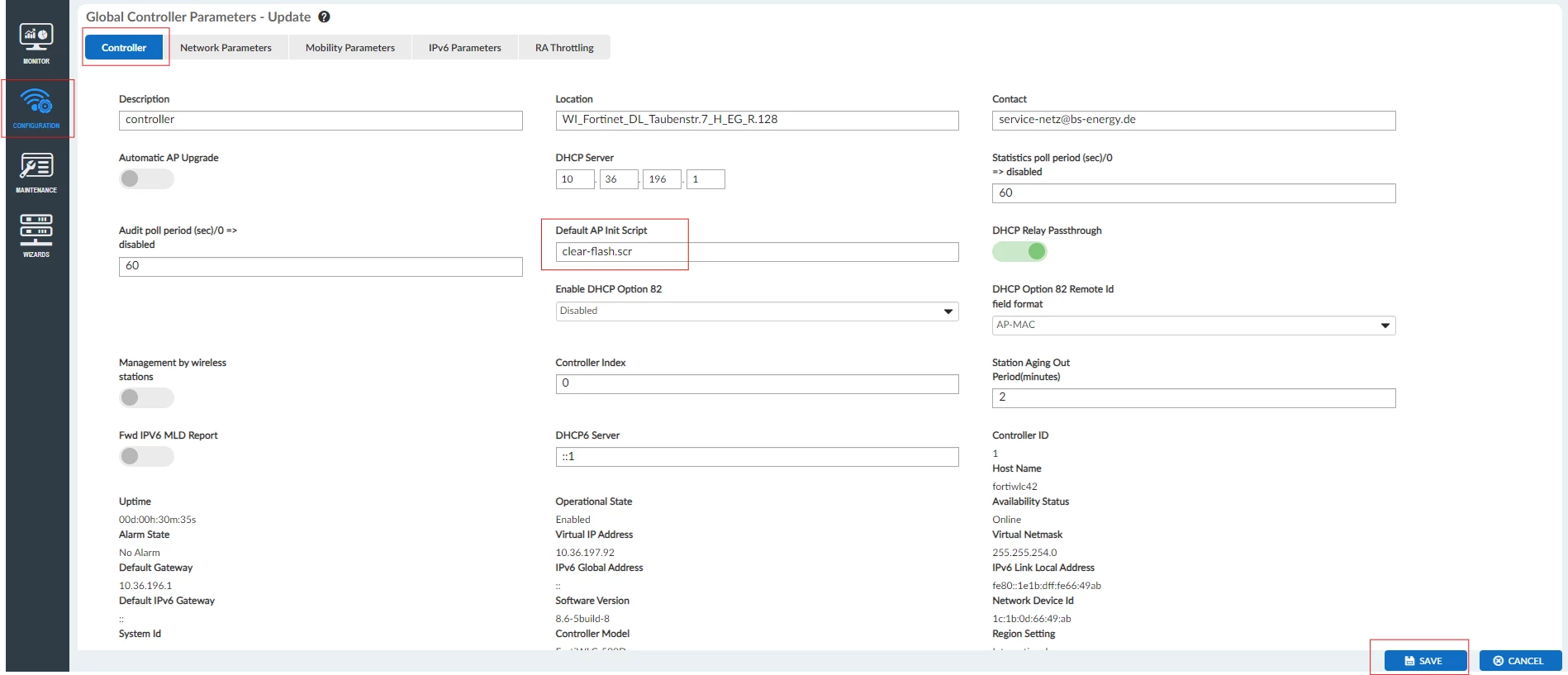

Step 2: Mapping the script as a boot script in controller: Navigate to Configuration -> Devices -> Controller -> Under 'Default AP Init Script, add the newly created script name 'clear-flash.scr and select 'Save'. To take effect, reboot all the APs.

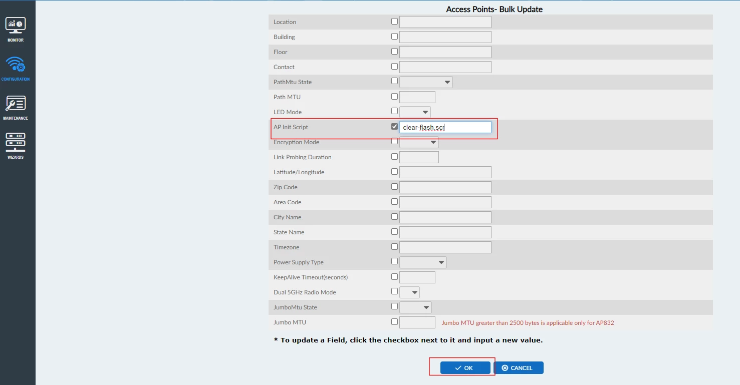

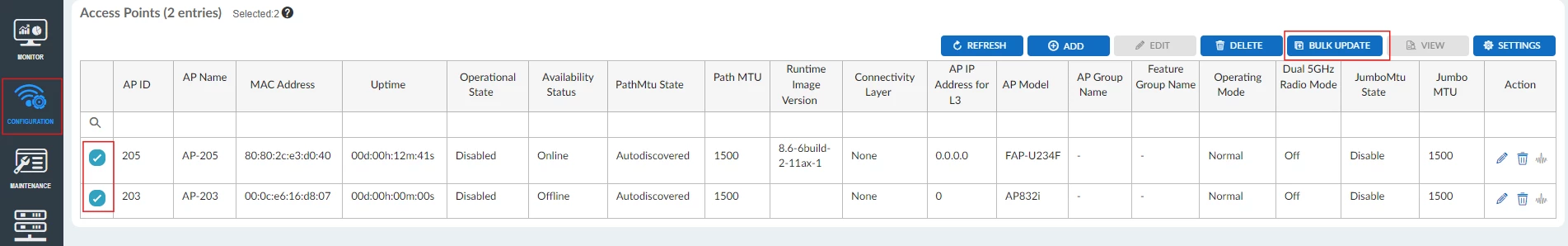

Step 3: Mapping it to required APsIf the script needs to be applied on all APs, map it in the controller and reboot the APs under Configuration -> Devices -> APs, select required APs or all APs,select Bulk Update', select the option 'AP-Init-script, enter the created script name 'clear-flash.scr' and select OK.
  • Reload all the APs or required APs so that the script content will be applied.
  • Once the AP is back online, connect to the AP and verify if flashlogs have been cleared.
