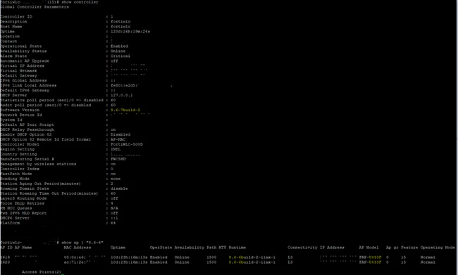

  1. Although 'Automatic AP Upgrade' is enabled on the FortiWLC, the FortiAPs running on v8.6-6 firmware would show 'Enabled/Online' on the FortiWLC that is on the new v8.6-7 firmware as shown below:
  1. This is the expected behavior on the new FortiWLC v8.6-7 version because v8.6-7 was released as a minor upgrade to v8.6-6, and due to that, 'Automatic AP Upgrade' will not upgrade the FortiAP from v8.6-6 to v8.6-7 version and FortiAPs running on v8.6.6 will be up and functional on FortiWLC v8.6.7, showing up as Enabled/Online.
