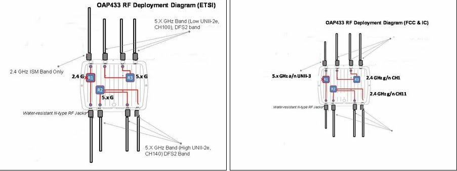

System Directory OS & OAP433e Radio Hardware Configuration Map (ETSI, FCC, & Industry Canada)
OAP433e is recommended for key regions in pan European countries (including to EU, EFTA, EU-Applicant, & EU-Candidate Members), US, & Canada.
OAP433e Recommended Installation with SD6.0 SR2 (ETSI, FCC, & Industry Canada)

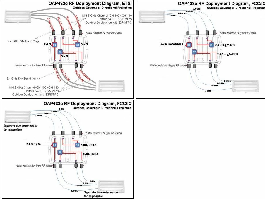

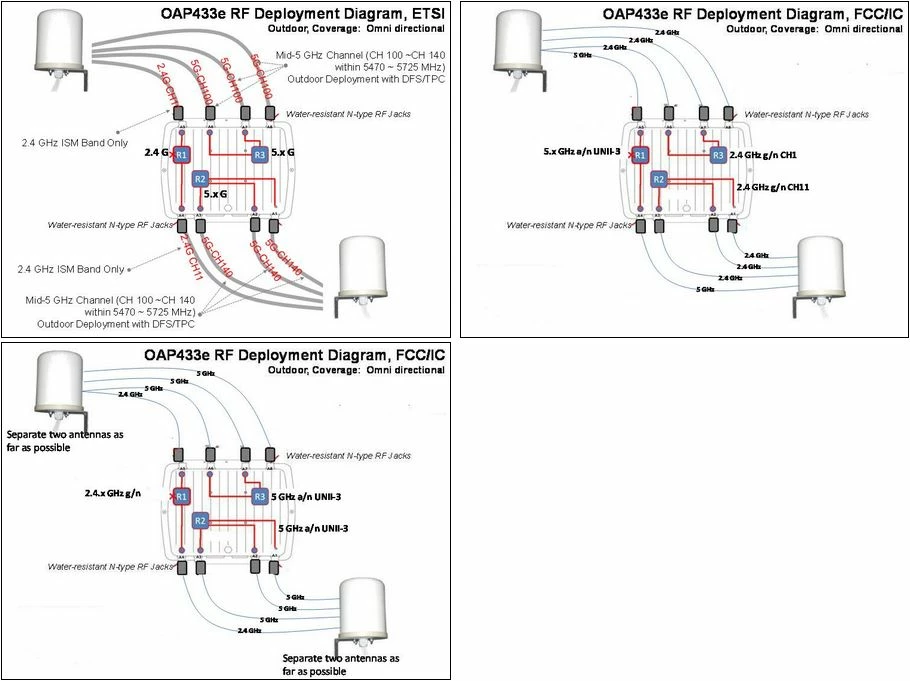

- OAP433e External Antenna, 2.4/5.x GHz dual band 6/6 dBi 0mni-directional outdoor antenna with 36-in RG58 coaxial cable, 4 leads with N-type water-resistance jacks (ANT-O4ABGN-0606-O-N)
- OAP433e External Antenna, 2.4/5.x GHz dual band 6/7 dBi directional patch outdoor antenna with 36-in RG58 coaxial cable, 4 leads with N-type water-resistance jacks (ANT-O4ABGN-0607-PT-N)
- OAP433e External Antenna, 5.x GHz single band 8 dBi Omni-directional, with single N-type water-resistance jack (ANT-A08O-NM-1 for UNII-1 & ANT-A08O-NM-2 for UNII-2e DFS band)
- OAP433e External Antenna, 2.4 GHz single band 8 dBi Omni-directional, with single N-type water-resistance jack (ANT-BG08O-NM-1 for ISM 2.4 GHz only)

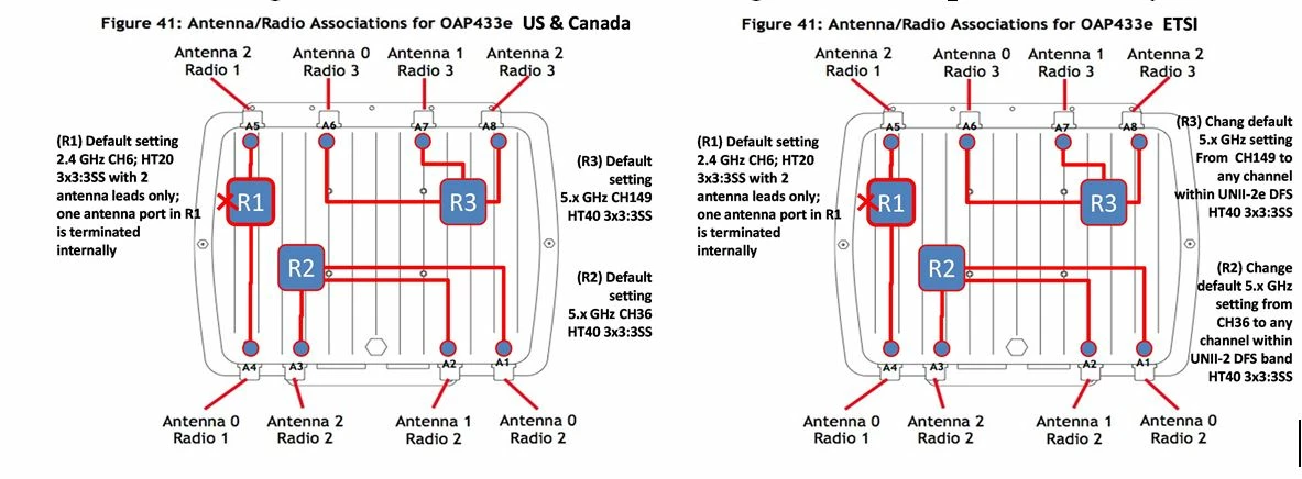

- ETSI, EC members as Austria, Belgium, Bulgaria, Croatia, Cyprus, Czech Republic, Denmark, Estonia, Finland, France, Germany, Greece, Hungary, Ireland, Italy, Latvia, Lithuania, Luxembourg, Malta, The Netherlands, Poland, Portugal, Romania, Slovakia, Slovenia, Spain, Sweden, United Kingdom.This equipment can be operated in other non-European countries as EFTA Countries: Norway & Switzerland, EU Applicants: Albania, Bosnia and Herzegovina, EU Candidate: Iceland, Macedonia, & Montenegro
- OAP433e Installation Recommendation (Omnidirectional coverage) with ANT-O4ABGN-0606-O-N
- OAP433e Installation Recommendation (Directional Patch) with ANT-O4ABGN-0607-PT-N
- OAP433e Installation Recommendation (Omnidirectional) with Reference Antenna (ANT-A08O-NM-1 for UNII-1 & ANT-A08O-NM-2 for UNII-2e DFS band & ANT-BG08O-NM-1 for 2.4 GHz)
