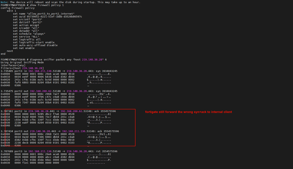

Now I set up an environment to test the“ anti-relay” function,Refer to the cli manual description. When anti-replay is set to strict, syn+ack packets with incorrect sequence numbers should be drop. However, when I tested, fortigate did not drop the wrong syn+ack packets,but forward this packet . Why don not drop the wrong seq packet? I debugged and saw that there was a debug saying This can be a challenge ack packet. What does this mean?

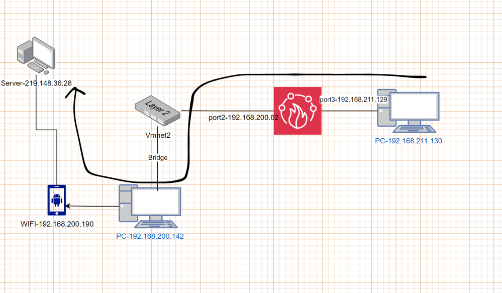

1. My topology is as follows

3. fortigate sniff

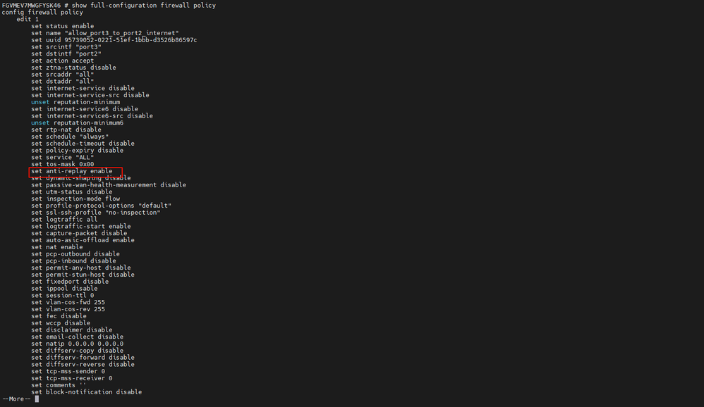

4. config system global ,set anti-replay strict
5. firewall policy ,set anti-relay enable
6. only how one firewall policy

Hi,
This is TCP Challenge ACK scenario. In Challenge ACK the client sends the SYN packet and Server will send the "ACK" Packet. If you see the screenshot which you attached it we don't have the SYN Flag set. Hence the Firewall is considering this as a challenge ACK. Challenge ACK is something deinfed in the RFC and those packets needs to be allowed.
https://datatracker.ietf.org/doc/html/rfc5961
After the challenge ACK the client will send the RST packet and close the connection and then start a new one.
Regards,
Shiva

thank you for your answer , i disable offloading in the firewall policy, but fortigate still forward the wrong syn+ack to internal client.
