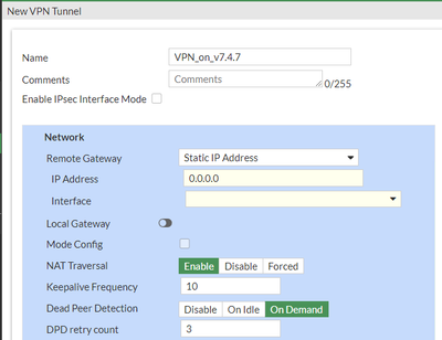

On Firmware Version 7.4.7 everything is fine. The checkbox is displayed and can be unchecked.

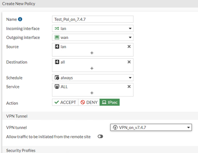

When creating a new policy i can switch the Action to "IPsec" an choose the VPN tunnel:

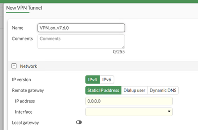

After upgrading the same Fortigate 40F to Version 7.6.0 the "Enable IPsec Interface Mode" is disappeared:

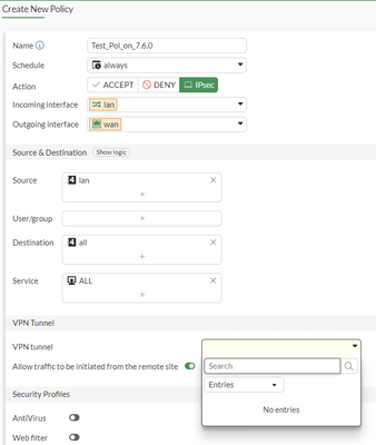

Without unchecking this option i can't choose the VPN tunnel in a new policy
