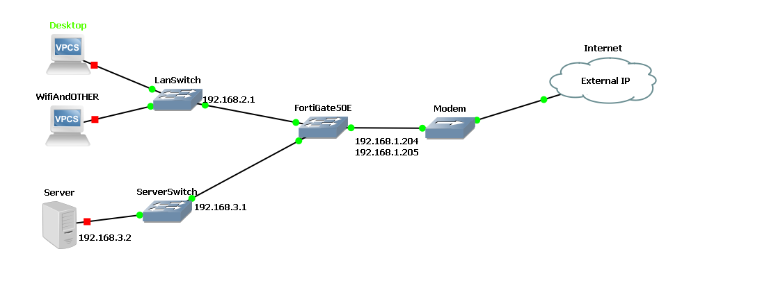

how did you connect the firewall in your network? which ports in which networks?
drawings help a lot in situations like this. is below what you setup?
from where are you trying to reach the VIP 192.168.1.204:8182 ? where is your PC connected at that moment.

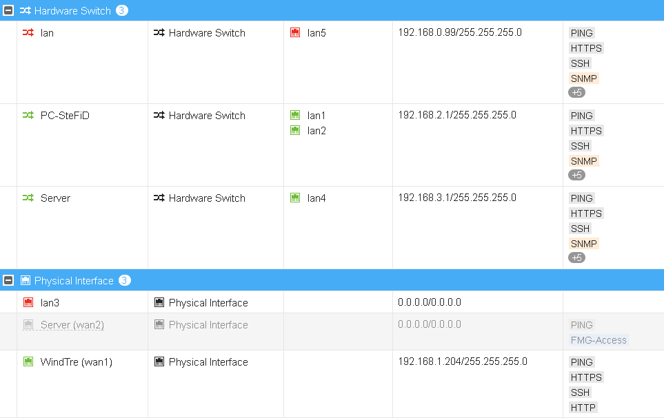

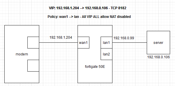

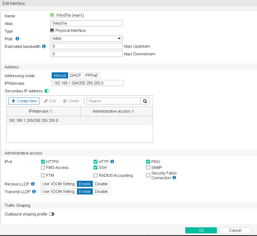

ok now that i'm home post photos of how i solved!
now this is how it works:
wan
lan/wan
VIP
Policy

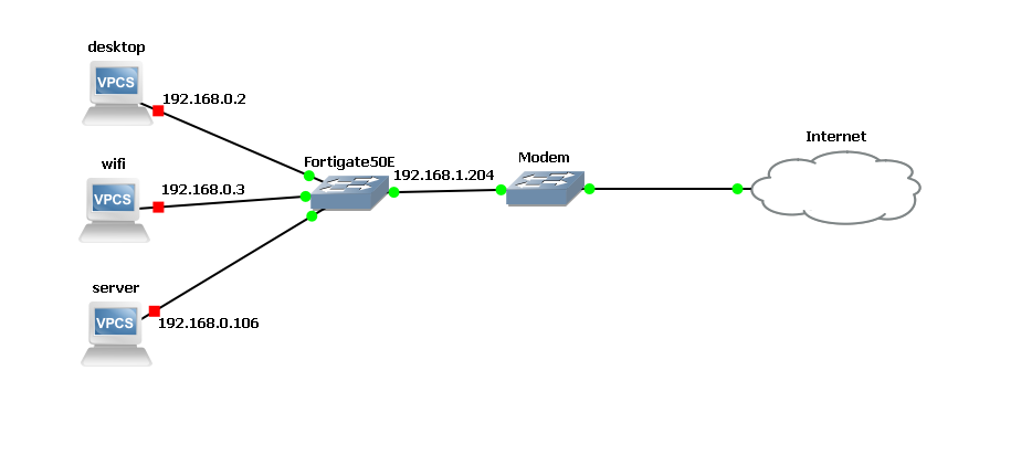

before it was like this and it didn't work:
