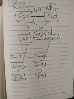

hi AEK,
thanks for your replying its highly appreciated.
sorry i cannot take a screenshot now as the customer isnt available but i put two port on fortigate under fortilink and disable split. and all vlans under it.
regarding to the diagram this is the diagram
fortiOS is 7.4.7
FortiswitchOS is 7.4.5

So far seems correct.
Split should be disabled as you did.
If you access switches are 1xx series then you cant connect the last one to the second ToR/Core. So what you did should be correct.
Waiting for the screenshot. But meanwhile, did you use VLAN id 1 for any of the created VLANs?

but when i search i found that i should connect each edge to the two core that working MCLAG not one only is this correct?
no i didnt use vlan 1

I mean when 1xx are chained you can't connect the last one to the second core. That's because 1xx doesn't support multi-homing when daisy-chained, while higher series support it.
However you can do so if the 1xx is standalone (for redundancy). This one is supported.

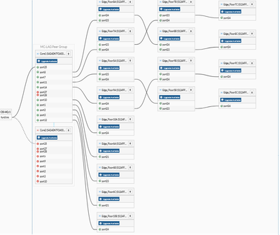

hello AEK,
kindly find the screenshot of fortilink
 one of the fortilink memeber is down as i have unistalled the mclag currently and make all network work on one switch as below
 and again i faced the same issue.
and didnt know the reason for this till now
