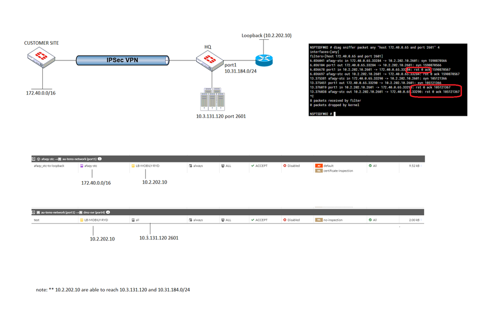

I need support, show below that port 2601 on server that is map on loopback 10.2.202.10 is getting reset, but going direct to server port is open.
Need some help why going to loopback is resetting.

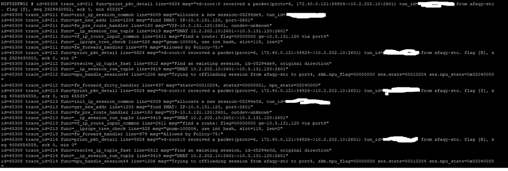

Hello @hbuenafe81 ,
Can you run these diagnose commands and share the output with us? While running these commands you need to try to access 10.2.202.10:2601
diagnose debug disable
diagnose debug flow trace stop
diagnose debug flow filter clear
diagnose debug reset
diagnose debug flow filter dport 2601
diagnose debug flow trace start 100
diagnose debug enable

Gents,
need help port suddenly stop working. Below debug for your informations.
regards,
Hello @hbuenafe81 ,
Do you have a VIP configuration related to 10.3.131.120:2601?

Hi @hbuenafe81 ,
I suspect on this line.
msg="VIP-10.3.131.120:2601,outdev-unknown

Isn't the 10.2.202.10 IP address defined on the router instead of FortiGate? If so, why do you need to nat on FortiGate?
If not, can you try writing a rule that will directly reach the "afaqy-stc-2601" vip object from the 172.40.0.0/16 network?
Source Intf : IPSEC Interface
Destination Intf : dmz Interface
Soruce Addr: afaqy-stc
Destination Addr : afaqy-stc-2601
Can you explain the flow of traffic a little more to make it clearer?
