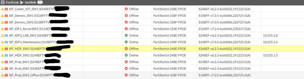

I recently deployed 11 Fortiswitches into an environment. I am using 6 248E-FPOE's, 1 124E-FPOE, and 4 108F-FPOE's. I have 2 of the 248's setup in a MCLAG config and the reset are downstream. The issue I am having is that after initial deployment, all switches were online and doing what they are supposed to do, but now I have 8 switches, including one of the Lag switches showing offline. I run the following commands to get status' and this is what I see for the Lag switch that is offline.

Why do they lose connection to the fortigate switch management?

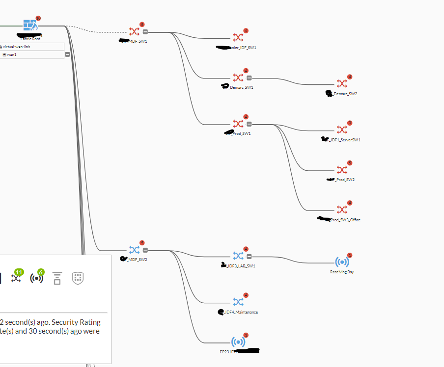

Can you show the topology from the Managed FortiSwitches console?

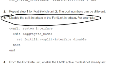

You need to enable split-interface on the FortiLink interface:
And do you have an ICL between the two MC-LAG switches?
Created on 04-21-2023 10:11 AM Edited on 04-21-2023 10:17 AM
It literally says "Disable the split interface in the FortiLink interface"

Oops my bad. Got it mixed up sorry bout that. Either way, I assumed you followed all of the instructions in that doc for setting up the MCLAG environment? i.e. mclag-stp-aware is enabled? STP is enabled on ICL trunks etc.
It's odd that you don't see the ICL in the topology view. Is it showing as up on the switch side?

I think because one of the core switches are showing offline, it won't show that link because it can't get info from the other core. Not sure what to do. Everything connected to it is passing traffic, but can't explain why they are showing offline. Most of the Down stream switches are connected to that offline coreswitch so that explains why so many show offline. If I can get that one back online, then the rest would show up I bet.
So that's why i'm wondering if you see the ICL as being up from the switch side of things. If the ICL is down then that explains why the other switch is offline (to prevent split brain).
Also are your downstream switches not dual-homed to the two MC-LAG switches? They should all still be online with a single link....
