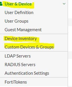

thank you , when we have installed 6.4.9 on vm , we have noticed major differences from 6.0.8 like there is no hardware switch or device and inventory as shown below
we currently using device inventory a lot in our 6.0.8 ip4 polices, do we need to change that before upgrading to 6.4.9?
thanks
Hello,
Hardware-switch is still available, but it will not be available in VM.
And yes, from 6.2 device inventory and device groups were removed and are not longer used in FW policy. I recommend to adjust these policies to source subnets/user groups correctly as after upgrade, these firewall policies will not contain device groups.
