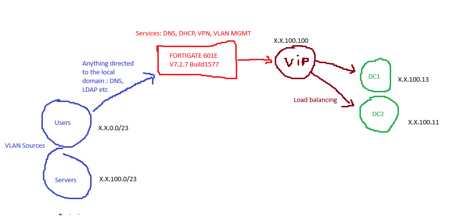

We use 3 DNS servers : 1 FortiGate DNS Server, and 2 DCs DNS. We can only use 2 IPs on most of our equipment, and we want to have FortiGate IP + Virtual IP (Load balancing to both DCs).
This means to stay on our LAN (X.X.0.0/16) only, and the VIP would be on the same network as the real servers.
Here is a scheme to get a better idea:

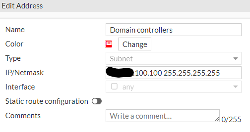

I do have a Virtual server, and a corresponding address. Here are my configurations :
VIP:
Address:
Policies:
The issue is, whether from vlan10 or vlan213, I can't access at all to my VIP. The thing is, I am getting timed out and I'm not receiving a destination unreachable error. Still, the Hit count of my vip or the traffic trough my policies stays at 0.

About the firewall policies, I can only put the address for the VLAN10 -> VLAN213 for example. That is why I created it to begin with, following the tip page I linked.
In facts, I can only add my VIP as a destination when the source interface is my VLAN213.
