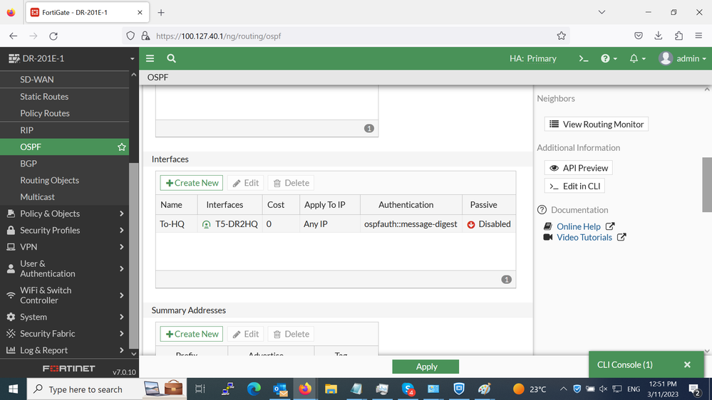

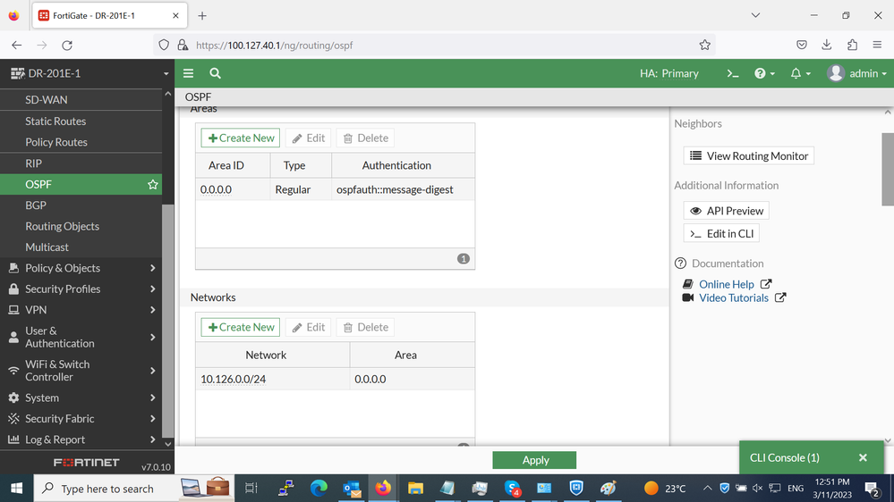

Hello Dear
after adding them to selector , now the ping is ok but unable to perferom OSPF adjecancy to the end node,

I think the issue is releated to OSPF authentication , so any debug commend could help me in order to see what is the issue with ospf adjecency ?
diagnose ip router ospf all enable
diagnose ip router ospf level info
diagnose debug enable
You can use the above command to enable the debug, to disable the debug use
diag debug disable
https://community.fortinet.com/t5/FortiGate/Troubleshooting-tips-for-FortiOS-routing-RIP-OSPF-BGP-st...
Check interface MTU with a CLI
get router info ospf interface
on both sides.
If not matching, either set a common interface MTU size manually or set mtu-ignore under ospf-interface config on both sides. You can do it either CLI or GUI (at least after 7.0).
