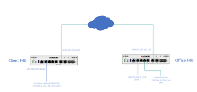

My office has an Fortigate F40 as our router and DHCP server.
I have a customer site where we have installed an F40 and use FortiClient to access their network. This all works great.
All I want to do is assign our local port 3 as a connection to our client's network on a full-time basis. I will be connecting equipment for testing purposes and have no need nor desire to access this equipment locally through the network. I ran through the steps from the cookbook, but somehow, I ended up exposing IP addresses at both sites to each other and caused some real mayhem. (Somehow added a 1-to-1 NAT within our local DHCP range, that was fun!)

Port 3 plan is as you say, any hardware connected to it would be as if it was on site at the customer end. I was hoping I could isolate port 3 from my local LAN completely and avoid the subnet overlap outright. Maybe I could add a VLAN?

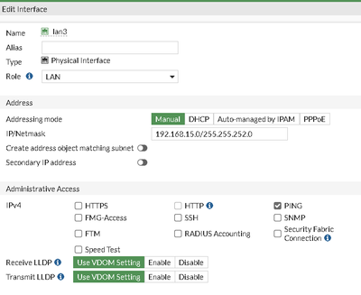

I set up the tunnel and it comes up, but I cannot ping from my local "port 3" to the client site. Wonder though if I have my interface setup correctly;
This may be beyond simple advice and fall into paid support, which I can entertain.
Yes your port3 is still overlapping with the remote end. 192.168.0.0/20 goes all the way to 192.168.15.255.
