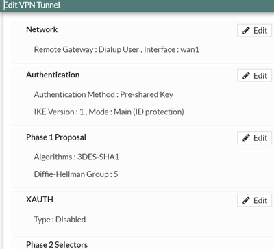

HI,
I'm trying to perform an ipsec between a fortigate device and a teltonika rut950, and I can't get it, I'm looking for an idea of why or if there is no compatibility

In the second image in the network part, you have "Dialup" selected, is the other device supposed to initiate the vpn tunnel creation process ?

i check the status of ike negotiation I can see that the tunnel rises and the negotiations are successful, until at a certain point it falls
The scenario is a Fortigate device with a public IP and a Teltonik cellular network device, which does not have a public IP, so I chose the dial up option. In the debug messages, I can see that ike negotiations begin and these are successful, dynamic tunnels are created, routes are added, until. ike 3:Teltonika_0:167: dec D8E1C348F9957B6BD40C8667F56292282E20250800000002000000282900000040000000800000018 ike 3:Teltonika_0:167: received informational request ike 3:Teltonika_0:167: processing notify type AUTHENTICATION_FAILED ike 3:Teltonika_0:167: AUTH rejected by initiator ike 3:Teltonika_0:167: schedule delete of IKE SA d8e1c348f9957b6b/d40c8667f5629228 ike 3:Teltonika_0:167: scheduled delete of IKE SA d8e1c348f9957b6b/d40c8667f5629228 ike 3:Teltonika_0: deleting IPsec SA with SPI c31d7597 ike 3:Teltonika_0:Teltonika: deleted IPsec SA with SPI c31d7597, SA count: 0 ike 3:Teltonika:25: del route 30.0.10.0/255.255.255.0 oif Teltonika(47) metric 15 priority 0 ike 3:Teltonika_0: sending SNMP tunnel DOWN trap for Teltonika ike 3:Teltonika_0:Teltonika: delete
