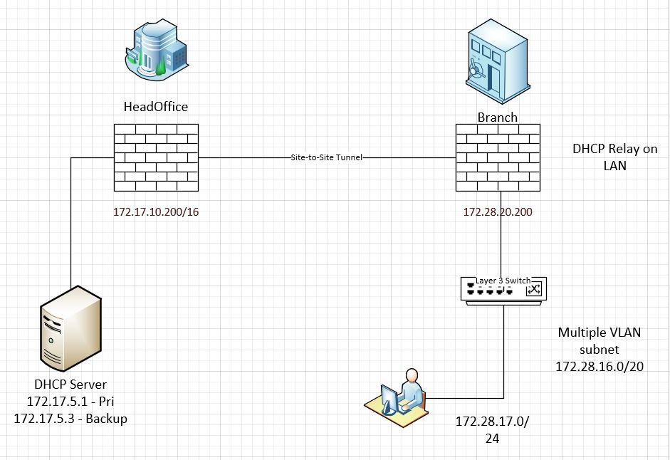

Currently, we have multiple sites, The basic topology I am using is Hub and spoke IPsec tunnel between the Head office and branch sites. We have multiple branch sites more than 10.
Currently, we have separate AD/DHCP servers on each site, As we are adding new branches connected to the head office, we are not planning to add separate AD/DHCP servers on small branches. And all the data AD/DHCP manage from the Head office via the IPSec tunnel.
The issue is the DHCP scope is created on the Hub site but the branch site is not able to get DHCP IP. As we have already configured the DHCP relay on the branch site LAN FW . But still not been able to get through and DHCP request at the spoke user end.
adding topology for reference.

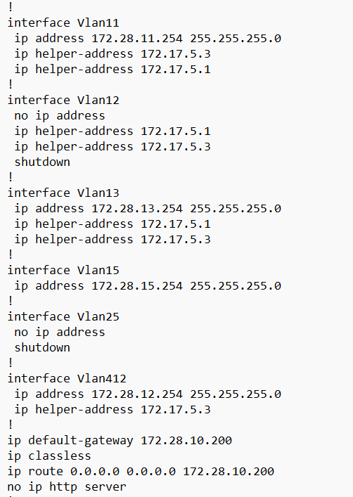

Hi @asengar ,
We have installed a layer 3 switch in the branch site with a different VLAN created and a default route toward Firewall.
Guide what configuration needs to be done on Layer3 switch Vlan. Currently, the IP helper address configures on the VLAN interface of the branch.
Snapshot for the diagnosis, we received a packet to the CHQ.

Hi,
172.28.12.254 is the Vlan interface IP of the branch user end. In Diagram, there is a bit mistake. 172.28.10.200 is Firewall IP > 172.28.10.151 is branch L3 switch and then 172.28.0.0/20 subnets within the interface configured. L# switch configuration is added for reference.
Most importantly how to check if the server end is offering DHCP IPs or not. The scope is created of all the branch VLAN with Gateway 172.28.12.254

interface Vlan1
no ip address
shutdown
interface Vlan2
ip address 172.28.2.254 255.255.255.0
ip helper-address 172.17.5.3
ip helper-address 172.17.5.1
interface Vlan4
ip address 172.28.4.254 255.255.255.0
interface Vlan5
ip address 172.28.5.254 255.255.255.0
interface Vlan6
ip address 172.28.6.254 255.255.255.0
interface Vlan8
ip address 172.28.8.254 255.255.255.0
interface Vlan9
ip address 172.28.9.254 255.255.255.0
interface Vlan10
ip address 172.28.10.151 255.255.255.0
interface Vlan11
ip address 172.28.11.254 255.255.255.0
interface Vlan12
no ip address
shutdown
interface Vlan13
ip address 172.28.13.254 255.255.255.0
interface Vlan15
ip address 172.28.15.254 255.255.255.0
interface Vlan25
no ip address
shutdown
interface Vlan412
ip address 172.28.12.254 255.255.255.0
ip default-gateway 172.28.10.200
ip classless
ip route 0.0.0.0 0.0.0.0 172.28.10.200

line con 0
exec-timeout 9 0
logging synchronous
login local
stopbits 1
line vty 0 4
exec-timeout 9 0
login local
transport input all
line vty 5 15
exec-timeout 9 0
login local
transport input all
PARAWT01DS151#
Hi,
Hi Najm,
I could see you have multiple VLAN's and each are assigned with /24 IP subnet in the L3 switch. So if that is the case how you can give a a single Gateway (172.28.12.254) for all these VLAN's? this is not correct. On the server you need to split the scope for each VLAN subnet and each should have its own gateway which is the VLAN interface IP on the switch for each VLAN (ie 11.254, 12.254, 13.254 respectively for VLAN 11, 12 & 13). Now when the DHCP packet are relayed from the Layer 3 switch it should exit out of the VLAN 10 which is your Interface connecting to Firewall and source IP of this Unicast DHCP packet should be 172.28.10.151 (Switch IP) and Destination (DHCP Server 5.1 and 5.3).
You can capture the traffic from FortiGate GUI or from the Server itself and analyze it using Wireshark to confirm if there are DHCP response with a lease.
