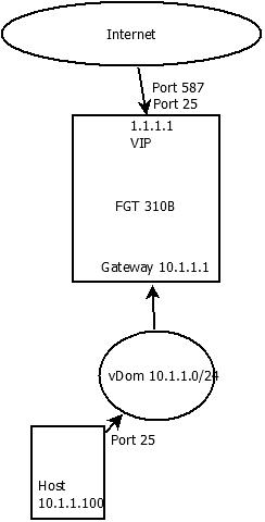

Hey Forum, maybe u can help me out? I would like to make a VIP port forwarding to an internal IP. As you can see in the networkplan, it should be mapped from 1.1.1.1:25 and 1.1.1.1:587 to 10.1.1.100:25. Is that even possible? If I follow the instructions from the Knowledge Base * i cant connect to 1.1.1.1:25. * http://kb.fortinet.com/kb/microsites/search.do?cmd=displayKC&docType=kc&externalId=12945&sliceId=1&docTypeID=DT_KCARTICLE_1_1&dialogID=33052695&stateId=0%200%2033050827 VIP without port forwarding -> port 25 works VIP with port forwarding -> port 587 works, port 25 doesnt work anymore. thx patrick ps: sorry for my bad english!

Hey, thx for your relay, sorry for my late relay, i was ill in bed the last days :-( 1. VIP edit " VIP1" set extip 1.1.1.1 set extintf " ext" set mappedip 10.1.1.100 next 2. VIP edit " VIP2" set extip 1.1.1.2 set extintf " ext" set portforward enable set mappedip 10.1.1.100 set extport 587 set mappedport 25 next is this right?

Your first VIP is non-portforwarding and so catches ALL the traffic to 1.1.1.1. Whereas the second VIP is port-specific. Both will " work" in the incoming direction but the problem is with outgoing traffic coming from 10.1.1.100:25. Looking at the mapping the Fortigate will send out port 25 traffic through VIP2, regardless of whether this is the way the traffic came in. In short, change VIP1 to be more specific: map port 25 to port 25. As a side note, you don' t have to use 2 external IPs to service 2 ports. Both external IP addresses could be the same, the traffic is distributed via the combination of external IP, mapped IP and port.

Hey @ll, i do for every port a vip with a forwarding. 1.1.1.1:25 -> 10.1.1.100:25 = VIP:25 1.1.1.1:587 -> 10.1.1.100:25 = VIP:587 1.1.1.1:110 -> 10.1.1.100:110 = VIP:110 and so on ... (yep, it' s a mail-server:-) Thank you!
